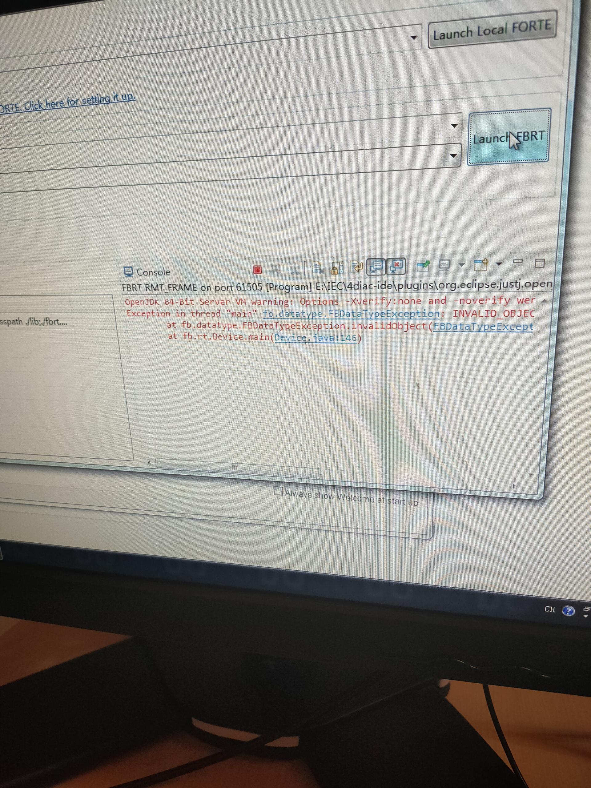

HI,
When I start the FBRT by RMT_FRAME, there are some errors , and the simulated window could be shown.
The error is in the attachment.
Thanks.
Re: FBRT could be startup. [message #1843098 is a reply to message #1843094] Thu, 15 July 2021 08:35 Go to previous messageGo to next message
which FBRT version you are using?
Re: FBRT could be startup. [message #1843107 is a reply to message #1843098] Thu, 15 July 2021 21:24 Go to previous messageGo to next message
It's FBDK11. The FBDK is 11.0 Version 20210526.
How to get the latest FBRT version?
Re: FBRT could be startup. [message #1843129 is a reply to message #1843107] Fri, 16 July 2021 06:42 Go to previous message
Unfortunately we never updated our runtime launcher to FBRT versions beyond 2. If you want to use them you need to run FBRT manually from the console and switch the device profile to FBDK2. The documentation how to start a RMT_FRAME from the console can be found in the FBDK docmentation:https://www.holobloc.com/doc/fbdk3/systest.htm
