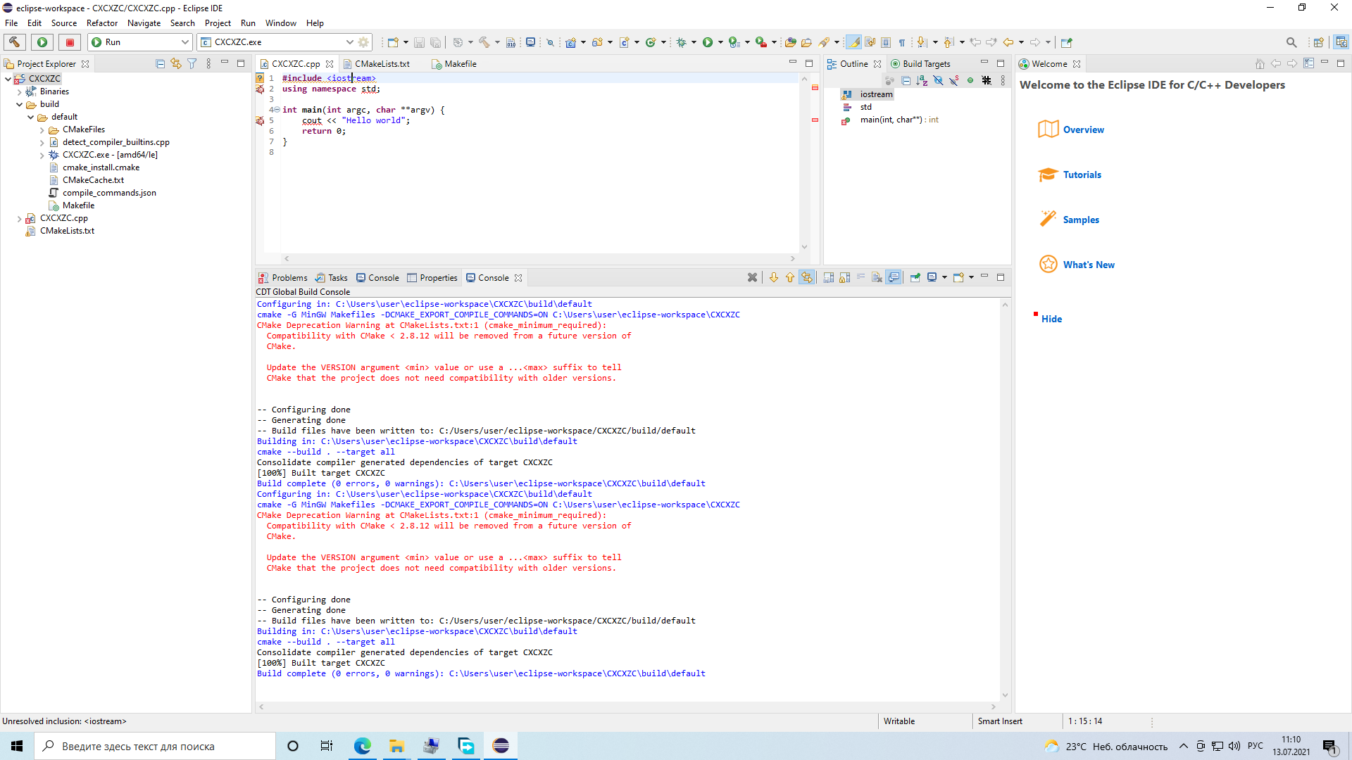

Window > Pereferences > C++ > Build > Environment
setting variables for eclipse
MINGW_HOME = ${MSYS_HOME}\mingw64;
MSYS_HOME = FOLDER IN WHICH MSYS2 IS INSTALLED
PATH =
${MSYS_HOME}\usr\bin;
${MSYS_HOME}\usr\include;
${MSYS_HOME}\usr\lib;
${MINGW_HOME}\bin;
${MINGW_HOME}\include;
${MINGW_HOME}\lib;
${MINGW_HOME}\include\c++\10.3.0;
${MINGW_HOME}\x86_64-w64-mingw32\include;
${MINGW_HOME}\x86_64-w64-mingw32\lib;
after that you need to restart eclipse
after that it was found that eclipse ide c ++ compiles the cmake project normally, but at the same time it gives errors that it supposedly cannot find the header files
