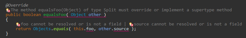

I upgraded to Eclipse 2021-06 (4.20.0). For Java classes, suddenly compile warnings and errors are displayed inline, i.e. within the source code, next to each line of code with the relevant problem.
How can I disable this, and only show warnings/errors in the left margin as before?
See screenshot.
Help appreciated.

This is likely just "code minings". Enter that in the filter in preferences and uncheck "Enable code minings".
Re: How to disable inline warnings/errors? [message #1842909 is a reply to message #1842907] Tue, 06 July 2021 01:34 Go to previous messageGo to next message
Confirming that was the case. Appreciate the help.
