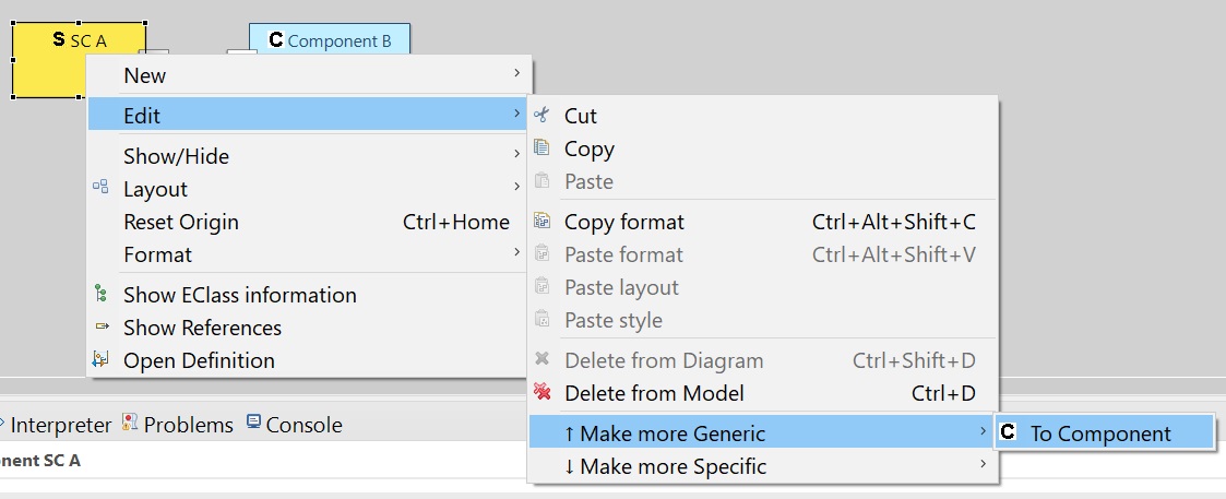

I am implementing some Java services for allowing changing the type of certain elements:
index.php/fa/40710/0/
index.php/fa/40711/0/
In the java service, I create a new model element, copy the old attributes and delete the original model element.

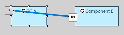

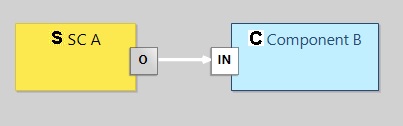

I finally managed to make Sirius place it in the same location and with the same size as the previous element, but I can't place the pins on the Container edge at the same position on the new container.
index.php/fa/40712/0/
How should I do it?
