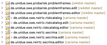

For developing purposes, I have all these metamodels in one Obeo instance (see screenshot). The Sirius files for the graphical modelers are contained in another instance which I start from inside this first Obeo instance.
I added the referenced models as dependencies and used the "Add Existing elements" tool for extending the metamodel with these existing elements.

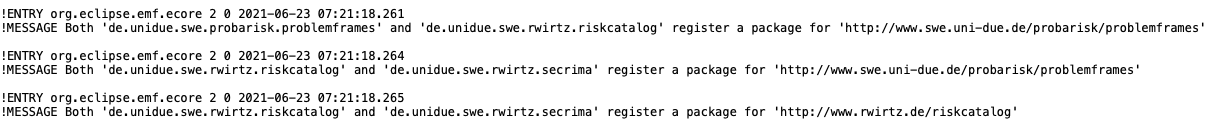

When starting the second instance, I get the message that some of the models are registered several times. Accept that I can select the metamodels several times from the registry, the modelers are working correctly and I can create model instances with my tools.

When removing the extension points of the referenced models, I got new exceptions like:
!ENTRY org.eclipse.emf.ecore 2 0 2021-06-23 07:50:42.382
!MESSAGE class problemframes.impl.ProblemframesFactoryImpl cannot be cast to class problemframes.ProblemframesFactory (problemframes.impl.ProblemframesFactoryImpl is in unnamed module of loader org.eclipse.osgi.internal.loader.EquinoxClassLoader @3ad794d; problemframes.ProblemframesFactory is in unnamed module of loader org.eclipse.osgi.internal.loader.EquinoxClassLoader @5b7aadea)
!STACK 0
java.lang.ClassCastException: class problemframes.impl.ProblemframesFactoryImpl cannot be cast to class problemframes.ProblemframesFactory

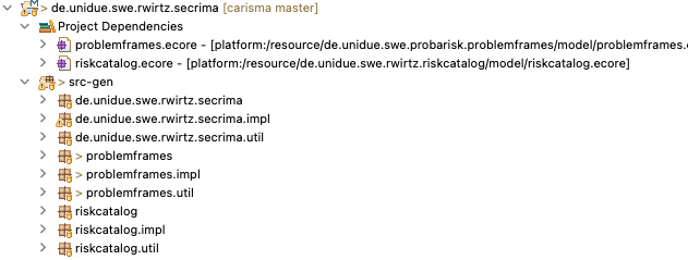

I notice that your ClassCastException refers to two different packages: problemframes.impl.ProblemframesFactoryImpl and problemframes.ProblemframesFactory. I couldn't reproduce your problem exactly but I had some trouble with dependencies when I was generating code and I think your problem might be similar.
I created 3 Ecore Modeling Projects, "ecore.project1" "ecore.project2" "ecore.project3", with ecore models that have similar dependencies to yours: project2 uses elements from project1, and project3 uses elements from the other two. If I do a "Generate Model Code" on Project3 and all its dependencies, the code of the 3 models is generated in ecore.project3. Your ClassCastException makes me think that you must have some "problemframes" code generated in a place where it should not be. It is better to generate only the code for model 3 in ecore.project3, as well as the code for model 2 in ecore.project2 and model 1 in ecore.project1.

- I removed all generated files and the *.edit and *.editor projects making sure that no old code is available. Furthermore, I delated all entries in the plugin.xml and the exported packages in the MANIFEST.
- I checked all base packages (the one for problem frames was missing).
- I generated the problemframes since it has no references to other models.
- I added the dependencies to other models as mentioned by Glenn.
- In the gen model of the referencing model, I further added the gen models of the referenced models using the attribute usedGenPackages.
After that, I could generate all models without any manual adjustments. There are no duplicate models in the plugin.xml anymore, and the services are working properly.
