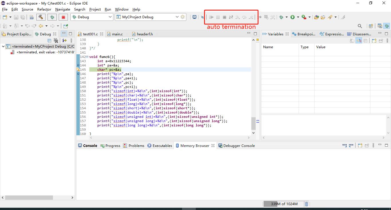

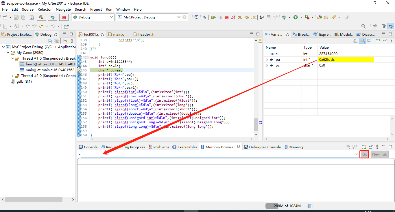

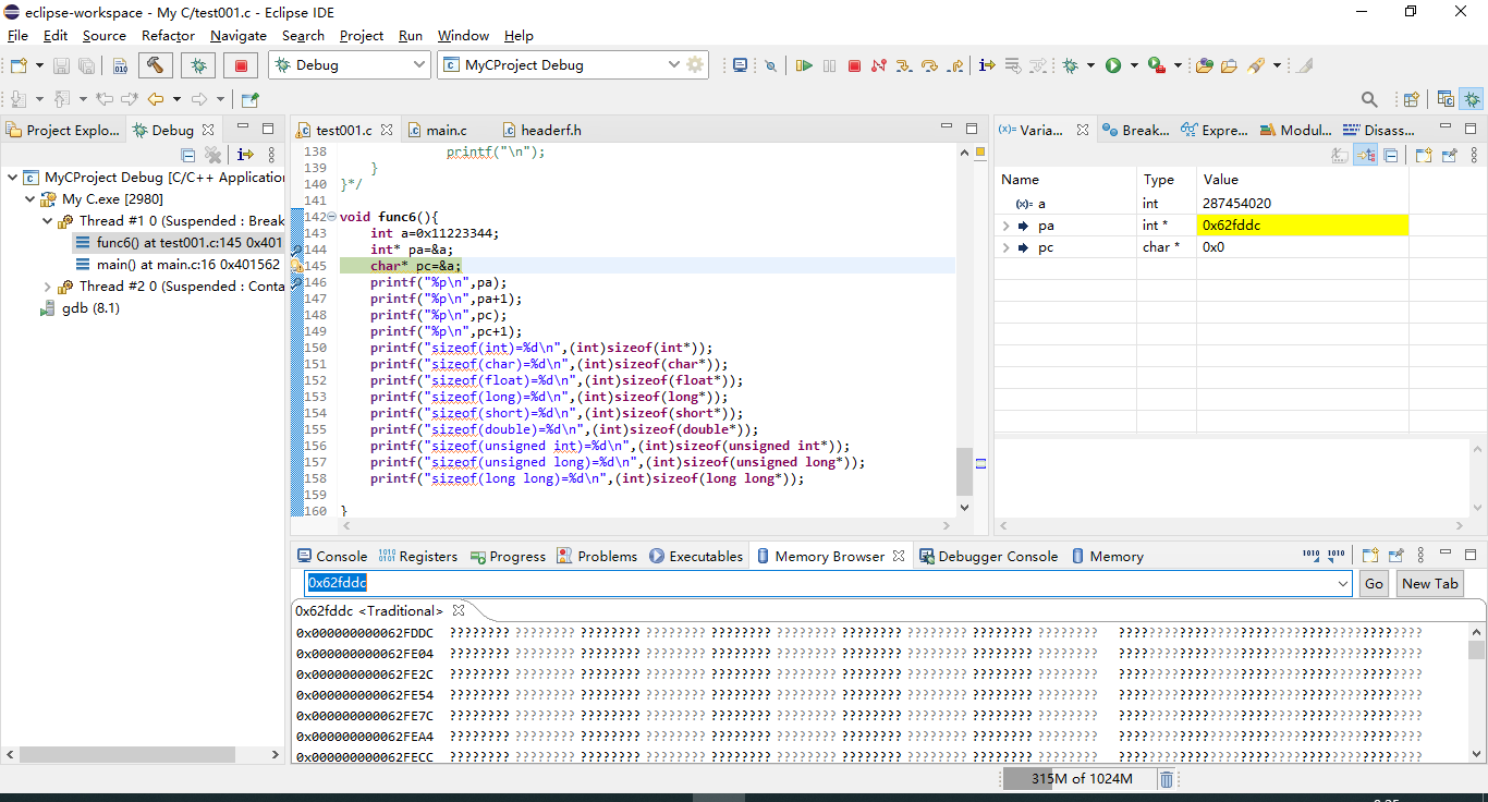

When debugging, check the memory variable value, and the adjustment automatically terminates. What is the reason?
As shown in the figure, 1624325058(1).jpg, 2.jpg, 3.jpp sequence, when you fill in the address to view the memory value, the debug will automatically terminate。
Ask the cause of the problem, thank you

The program terminated with a negative exit code.
In Windows this usually indicates a Windows error code.
Convert it to a 32-bit hex value and do a web search for it.

The OP wants to look around an automatic variable's address. The automatic variable is in the function's stack. There is little to gain from printing the address,
as it is probably different on different calls to the function.
The bulk memory access may extend out of the legal address range and it can raise a memory management exception which kills the process.

I solved downgrading the gdb from 10.2 to 8.3. Now everything works perfectly.
