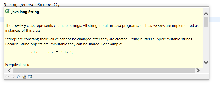

I have an eclipse-rcp project which is used to develop embedded software (C/C++ projects). I would like to display a custom tooltip when the mouse hovers for a couple of seconds over a line of code in the code editor of the C/C++ perspective. The text should contain the path and name of the file and the line number at which the mouse is hovering. Something like when you hover over a class name in the java editor (find the attached image).
What is the correct way to implement this?

I had a similar problem, when activating the 'hover' feature for C++ code in eclipse.
In this case, the Doxygen documentation (= my 'customer tooltip') had to become visible when hovering with cursor over a word.
This did need the modification of several items to get it working.
In your case, it looks somewhat easier: I assume, that you have alredy added the cdt-hover plugin in eclipse.
In that case, you just need to adapt (edit the java code) the plugin 'org.eclipse.linuxtools.cdt.libhover'.
There exists a function 'getFunctionInfo' in file 'LibHover.java'.
Whenever you hover with cursor over any word in your C++ text-editor window, then this function is called. (make a breakpoint there for debugging).
Inside that function 'getFunctionInfo', there is a line like 'IRegion region...'.
This variable 'region' will contain offset and length of the hovered word inside your file.
You can then use this information to create your 'custom tooltip', which is for me the same as a 'hover information'.
