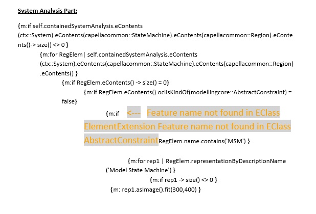

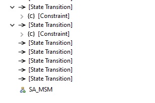

I'm having an issue when implementing a MSM diagram to my document, because MSM diagrams are stored in a system file of Capella that contains Constraints too, I can't seem to find a way to reach my diagram without encountering those constraints ...
I run on Capella 1.3.2.

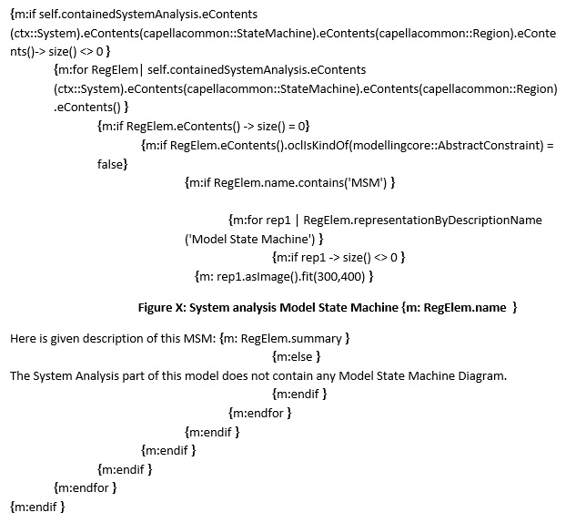

My code (i've already downloaded nsUrls to make everything work, as the oclIsKindOf, ...) and the errors are attached to this post. I don't understand why the for loop enters the Constraints elements whereas I've created a condition that should prevent that.
If anyone could help me in this matter, it would be greatly appreciated.
Thanks in advance for your time and help!
