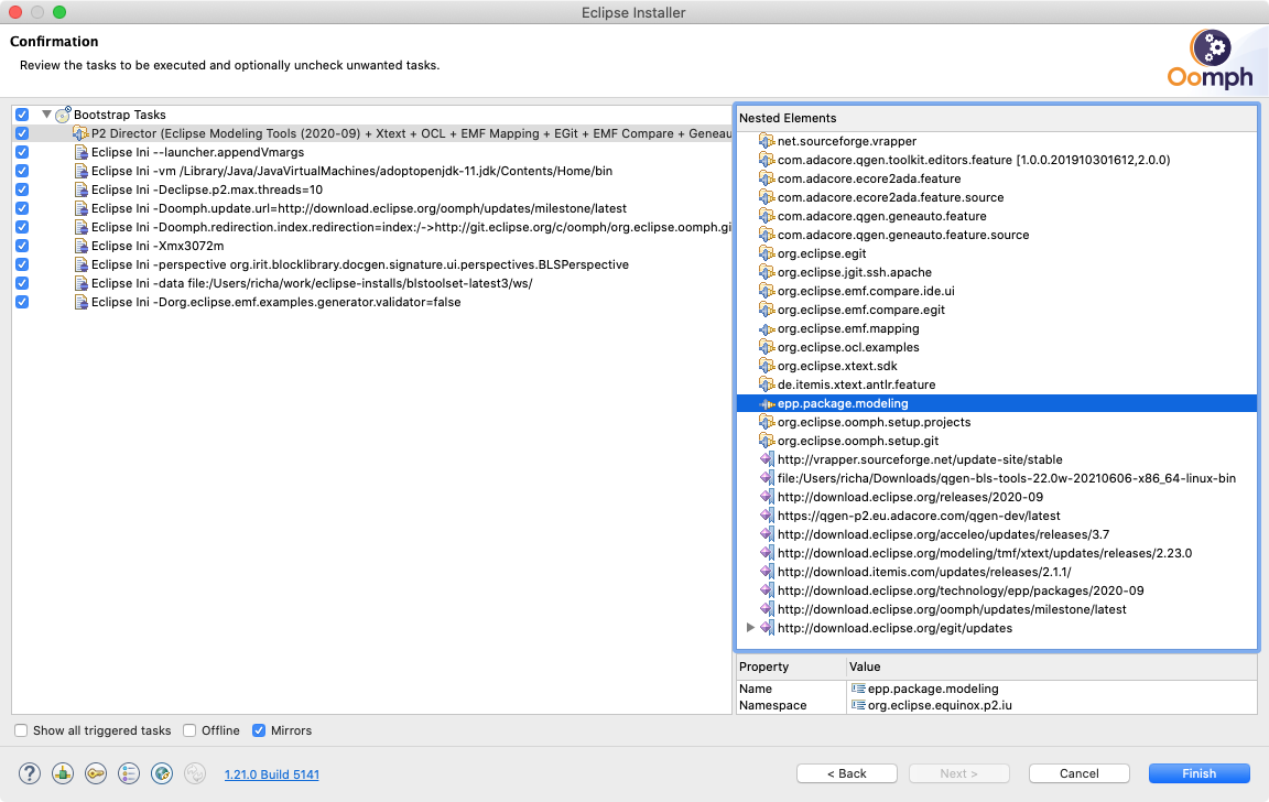

Here's my product definition in the Eclipse Installer. It's based on Eclipse Modeling Tools 2020-09 + additional third-party and in-house plugins.
index.php/fa/40613/0/
That step proceeds successfully. In particular I can see these plugin versions installed (this will be important later):

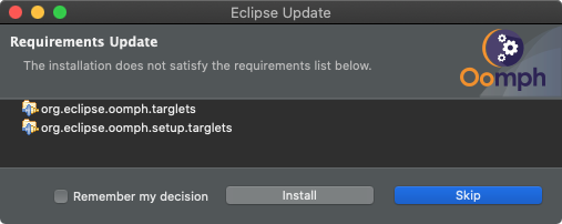

After the new Eclipse installation starts, Oomph asks to install org.eclipse.oomph.targlets and org.eclipse.oomph.setup.targlets:
index.php/fa/40614/0/
I accept. This time Oomph installs newer versions of the Google plugins:
