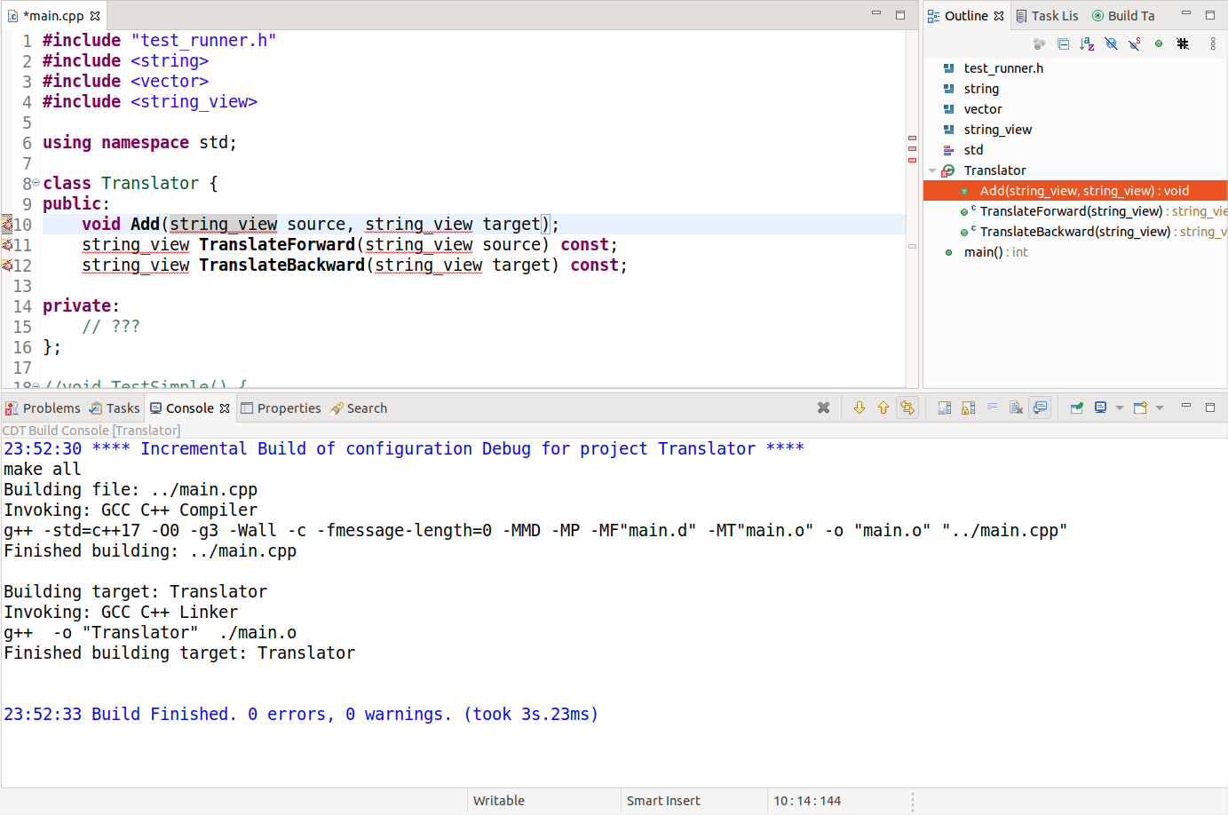

Please, help.
Editor underlines string_view as error: "Type 'string_view' could not be resolved"
The <string_view> is included. In Properties/C/C++ Build/Settings/Dialect c++17 is chosen.
When I build project there are no errors in console, but there is an error in editor. Program is working, but editor's bug irritates me.

Re: Editor underlines string_view as error [message #1842144 is a reply to message #1842126] Thu, 10 June 2021 04:26 Go to previous message
Properties --> C/C++ Build --> Settings are only used for building Makefiles in a Managed Build project.
In fact, they are only present in such a project.
You also need to change the the builtin provider command to alert the Indexer.
The default standard for GCC depends on the GCC version.
Some (mine for instance, 9.3.1 20200408) default to c++14
Here's the latest from GNU: https://gcc.gnu.org/projects/cxx-status.html
Says 2014 C++ standard is the default from GCC 6.1 up through GCC 10.
Add -std=c++17 to the provider command at
Properties --> C/C++ General --> Preprocessor Include Paths, Macros etc. --> Providers tab
${COMMAND} -std=c++17 ${FLAGS} -E -P -v -dD "${INPUTS}"
The provider doesn't always run right away.
May not take effect until the next build.
Forcing a console to be allocated to it sometimes causes it to run.
You may still need to rebuild the index.
The value for __cplusplus should be greater than or equal to 201703L.
You could also add it to the User Settings Entries on the Entries tab.
Please don't embed such large images.
The web software use by Eclipse doesn't handle it well.
Smaller screens may not get a horizontal scroll bar.
And even when they do, it forces constant scrolling to read the post.
It's one of the reasons why I put sentences on separate lines.
