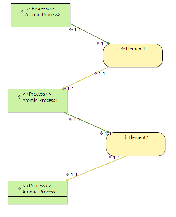

I am going through the example for how to create tabular representations of my model and I am confused about how the columns are supposed to work. My test model is the following:
index.php/fa/40607/0/

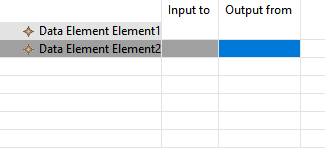

What I want to do is to have the process nodes (the green boxes) appear in the columns next to the data nodes (the yellow boxes) like so:
index.php/fa/40608/0/
My confusion is about what to put in the feature name section of the properties of my columns. The data and process nodes are connected by element based edges which is different from the example so I can't just blindly copy it. Any help would be greatly appreciated.

Hi Maxime,
I have been able to get the table to computationally generate the labels using aql but not using the feature parent expression box. The command I've been using is
aql: self.input.tgt.name
That works fine for when I only have Data as the rows, but if I want to add Atomic Process to the rows too then I need more granularity to be able to access the feature parent since the Input class is shared between data and process. I would like one column to be filled purely based on data rows and another column to be filled purely based on process rows. I'm not sure how to achieve that kind of granularity.
