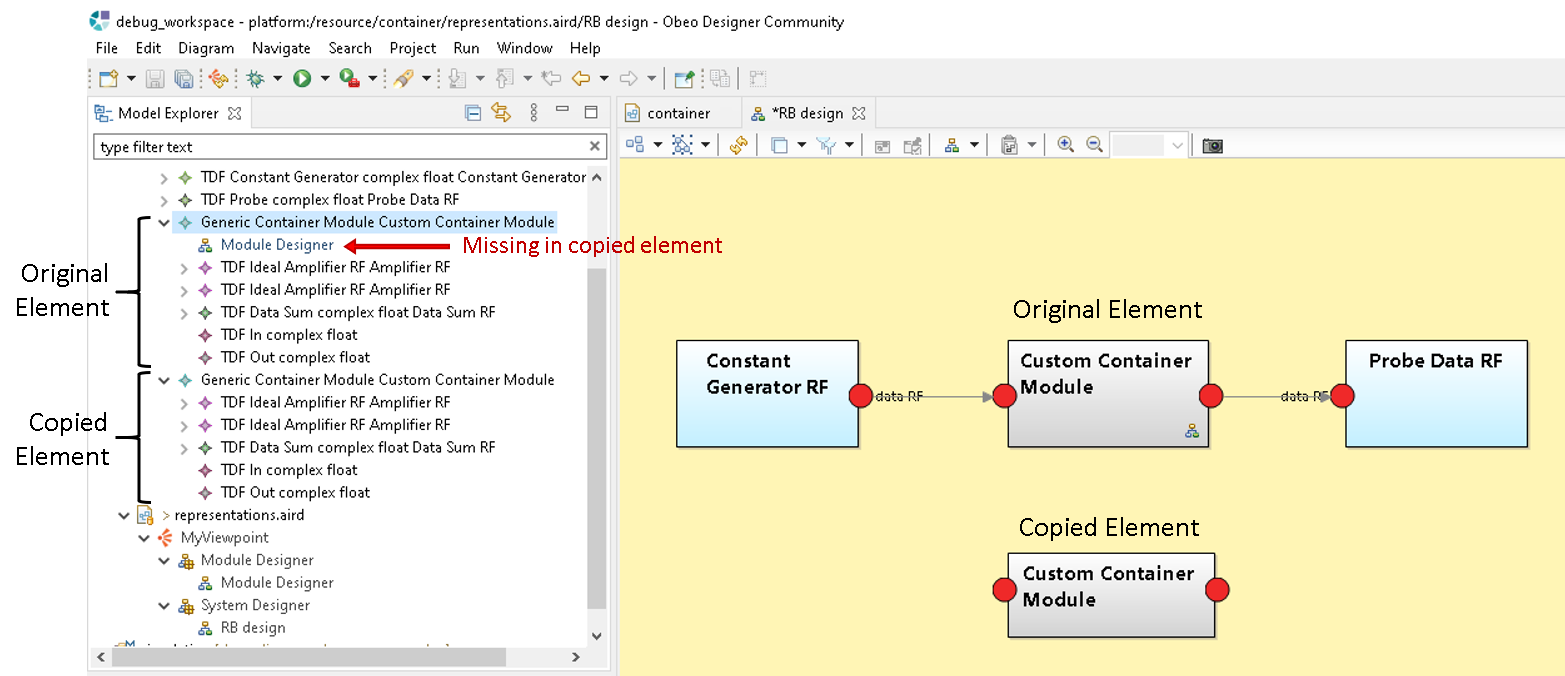

I have a representation where processing modules are defined as Containers and the input/output ports are Nodes on the border of these Containers.
Some of these modules can be created as macro-modules. A macro-module appears as normal module in the root representation ("RB design" in the figure) but if I do double click, I open it and I can see the internal representation ("Module desing" in figure). This internal representation is created the first time I open the macro-module.
My problem is that when I copy a macro-module, the default behavior of sirius is to copy the macro-module and its content (i.e. all sub-modules), but it doesn't copy the related representation ("Module design").
Only if I do a double-click on the copied marco-module a new "Module design" representation is created (as default operation in my VSP) and I can found all the submodules with their connection (but with a random displacement).
How can I copy also the representation with a simple copy&paste?
I think I have to add "New Element Edition" => "Paste" and map it to the macro-module, but it's not to clear which operation I can use for copying the representation.

The Sirius copy&paste is a "semantic/business" copy/paste by default : it copy an paste your domain model element and then the refresh is triggered on the targeted diagram to update the representation.
In your case, it seems that you could define a paste tool, associate it to your mappings and trigger the creation of the wanted representation in the tool definition. Note that there are also apis to copy and paste the layout.

my aim is to copy in the new element also the representation of the original element (I think that representation is the same thing of layout).
In the figure, in the tree of project, the original element (the "Generic Container Module Custom Container Module" above) has associated the representation with the name "Module Designer". The copied element has all the content of original element except the "Module Designer" representation that is missing. When I do copy&paste I'd like to copy also this information.
