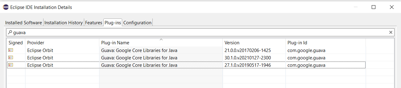

loader constraint violation: loader org.eclipse.osgi.internal.loader.EquinoxClassLoader @477ad3b6 wants to load interface com.google.common.collect.Multimap. A different interface with the same name was previously loaded by org.eclipse.osgi.internal.loader.EquinoxClassLoader @3a161902. (com.google.common.collect.Multimap is in unnamed module of loader org.eclipse.osgi.internal.loader.EquinoxClassLoader @3a161902, parent loader 'platform')
I tried to delete <workspace>/.metadata/.plugins/org.eclipse.e4.workbench/workbench.xmi and restart my workspace. However, the problem sustained.

What you're getting here is an issue with multiple different versions of google Guava installed in the same eclipse instance. I don't know which two products you've installed that depend on different versions, but you will have to make sure only one Guava version is present in your eclipse (by uninstalling the offending ones).
Which EMF Compare version are you using in this eclipse? This will allow me to tell you the range of guava versions supported by that EMF Compare.
