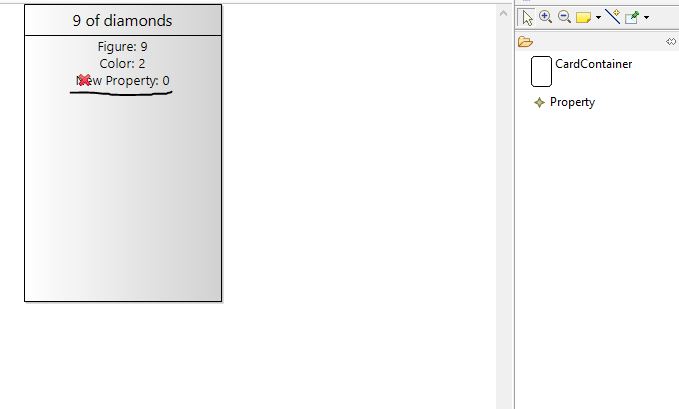

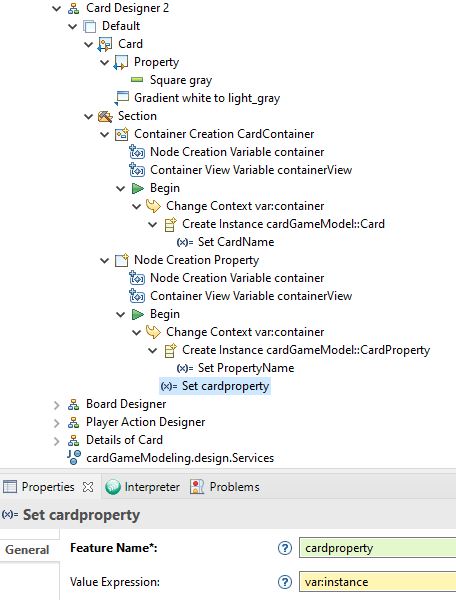

I have model representing a card game. Card has many properties. I created diagram with tool which allows to create cards(containers) and adding properties(sub-nodes) to them. The problem is that newly created property is marked by red cross and I cannot modify it. Inside tool I create instance of property and I set relation between card and property. Should I do something else? In console i get message: "Error saving resource. The object is not contained in a resource."I put here some screens to make it more clear.

In the "Create Instance" operations you must specify a "Reference Name". It must be the name of a *containment reference* of the parent element (see https://www.eclipse.org/sirius/doc/specifier/general/Model_Operations.html#create_instance). Otherwise Sirius will indeed create and instance, set the reference from the "parent" to the new instance, but if that reference is not a containment reference the new instance is dangling and not really attached to the rest of the model and will not be saved as it is not considered part of any resource (hence the error message).
It's possible that you misconfigured your metamodel and forgot to check the "Containment" property for the EReference between Card and CardProperty.
