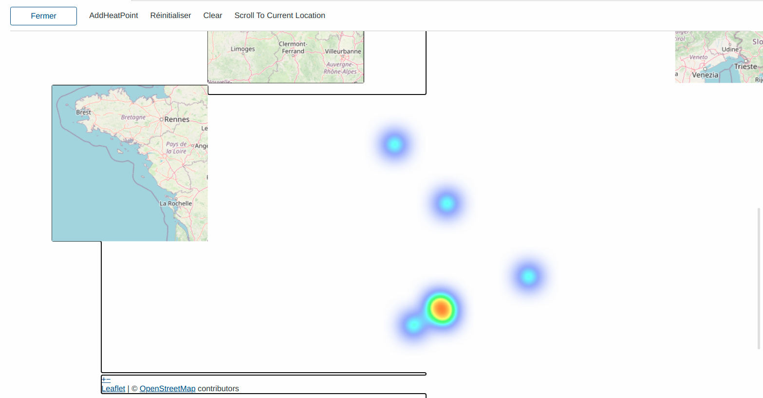

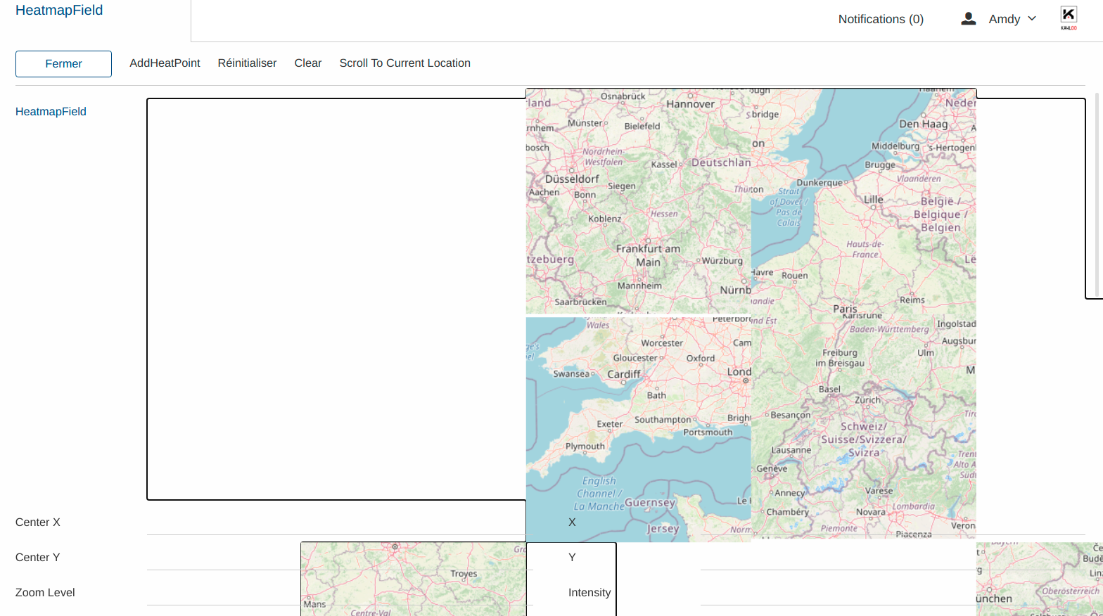

I was implemented the heatmatField in my project and i have a map ho showed in out side the field like they pictures
index.php/fa/40575/0/
index.php/fa/40576/0/
I need a help please. Thank for advance.

Hi Amdy
Yes, your apps looks definitely broken :) Only by looking at the screenshots, I can only guess what's wrong.
My first idea is, that the CSS/stylesheet for your custom widget is not properly loaded or your LESS imports for the heatmap widget are missing or wrong.
Since the Heatmap widgets runs without problems in our own widget application below, I'd start to compare the two applications.
Inspect the Heatmap widget with the dev tools (F12) of your browser and compare which CSS styles have been applied to the widget and where the style definition is located.
Maybe this will lead you to the source of your problem.
https://scout.bsi-software.com/widgets/?dl=widget-heatmapfield
Cheers
André
