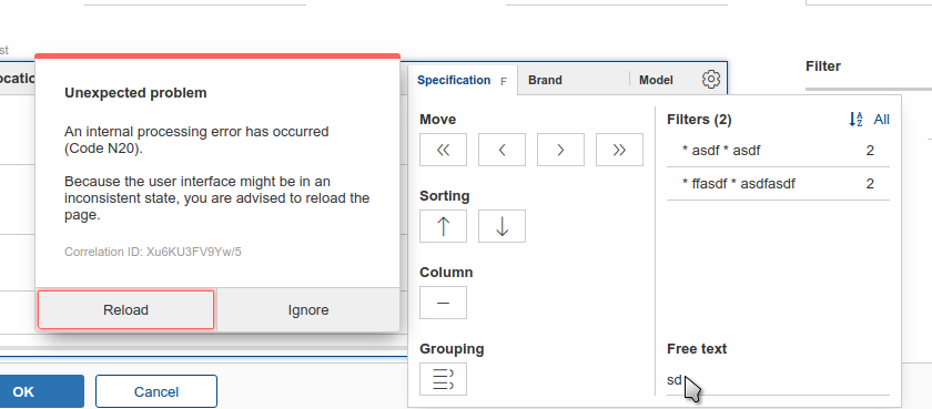

I am facing this problem when using the default table filter mechanism.

but on tablepage the default filter mechanism works just fine..

Re: NullPointerException [message #1841766 is a reply to message #1841763] Fri, 28 May 2021 01:58 Go to previous messageGo to next message
I solve the problem.
Before, i use initTableInternal() method to initially load the data into the table itself, like:
before:
					protected void initTableInternal() {
						// TODO Auto-generated method stub
						deleteAllRows();
						Object[][] result = BEANS.get(IXXService.class).getXXTableData(..);
						addRowsByMatrix(result);
Every time i will use the table default filter mechanism it always throws a NullPointerException error, i do not know yet as to how or why, hope someone could give me a hint. But after removing the
initTableInternal()
though the table is empty but the filter mechanism just works fine. So, to initially load the table data i have tried to use
initFieldInternal()
method of the form, like:
after:
					protected void initFieldInternal() {
						deleteAllRows();
and hollah, it works.. The data is loaded into the table and the filter mechanism works.. SOLVED!
But the question remains, why is it using
initTableInternal()
throw an error exception, is it related to my code within the method? I like to know the exact reason. If you have any idea please share it to me.. Thank you..
