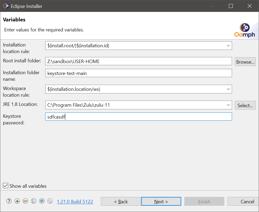

Variables screen:
The variable for "useroption.keystore.location" is not shown ("Show all variables" is always checked ). I saw it a few times but now it does not appear anymore.

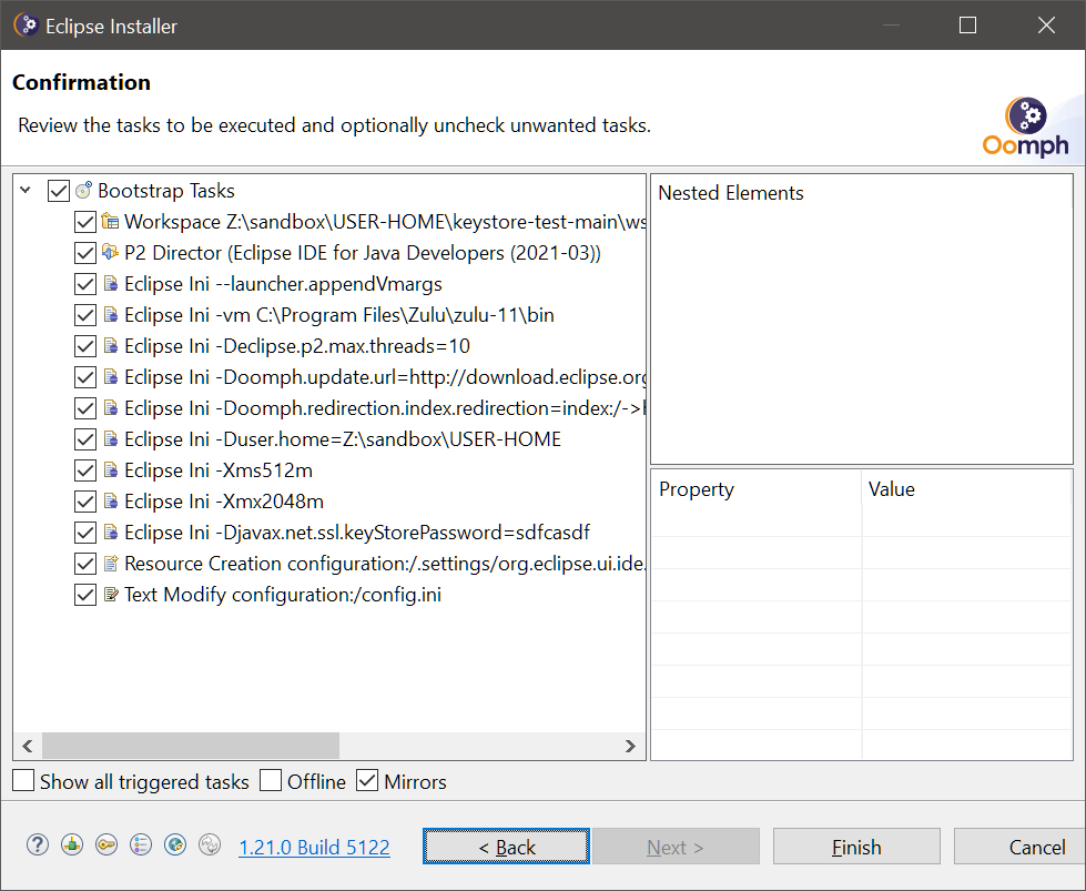

Confirmation screen:
Unsurprisingly there is no task to setup the keystore location.
