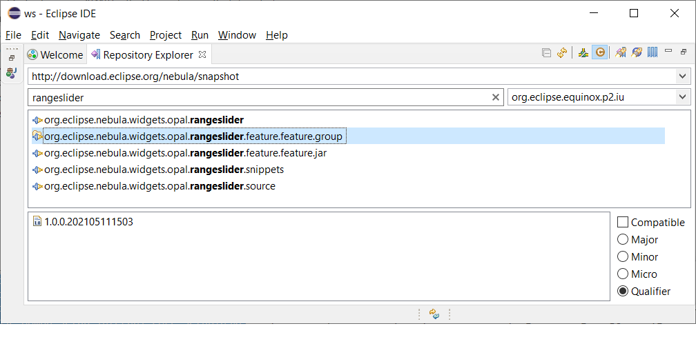

After adding nebula RangeSlider support in SWTBot, targets and oomph setup files were updated to have it. SWTBot Oomph setup gives error as:
Missing requirement: artificial_root 1.0.0.v1621045983469 requires 'org.eclipse.equinox.p2.iu; org.eclipse.nebula.widgets.opal.​rangeslider.feature.feature.group 0.0.0' but it could not be found
Repository Explorer can show this feature. Attached image.index.php/fa/40492/0/
Why then rangeslider feature is not found?

Re: Cannot complete the install-one required item could not be found, but shown in Repository Explor [message #1841418 is a reply to message #1841416] Sat, 15 May 2021 01:18 Go to previous messageGo to next message
This is a little bit of a trick question. Apparently a human cannot see the difference between 'org.eclipse.nebula.widgets.opal.​rangeslider.feature.feature.group' versus 'org.eclipse.nebula.widgets.opal.rangeslider.feature.feature.group' but a computer notices that the '.' after opal of the first string is different from the '.' after opal in the second. Goodness knows how you created this string but note that you can drag things from the Repository Explorer and drop them as Requirements in a Setup editor to avoid typos.
Re: Cannot complete the install-one required item could not be found, but shown in Repository Explor [message #1841421 is a reply to message #1841418] Sat, 15 May 2021 12:56 Go to previous messageGo to next message
Hi Ed,
I changed oomph setup file by drag drop from Resource Explorer https://git.eclipse.org/r/c/swtbot/org.eclipse.swtbot/+/180630
I also see that line for rangeslider feature name is changed for that dot. But still I get the same error from Oomph setup. Could you please give further suggestions?

Re: Cannot complete the install-one required item could not be found, but shown in Repository Explor [message #1841423 is a reply to message #1841421] Sun, 16 May 2021 02:36 Go to previous messageGo to next message
I tested your setup from scratch just now and it worked for me. It can take annoyingly long for this job to update the setups.zip
https://ci.eclipse.org/oomph/job/setup-archiver/
Firstly the server keeps server a cached older version of that zip even when it is updated and also git.eclipse.org servers cached older versions of the resources for quite some time ever after a commit.
But in your IDE you have the SWTBot setup redirect to your local resource so you should be able to see it working once the clone exists in that IDE...
Re: Cannot complete the install-one required item could not be found, but shown in Repository Explor [message #1841437 is a reply to message #1841423] Mon, 17 May 2021 02:00 Go to previous message
