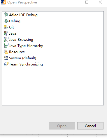

can any one help me?
this is the picture

the deployment perspective was removed with 4diac IDE 1.13.0. You can deploy either with the run menu or with the context menu. In both cases the deployment depends on your selection. i.e.,
- system configuration: all devices and resources
- device: full device
- resource: only the resource
If more elements are selected all the selected elements following the rules above. The deployment console is with 4diac IDE 1.14.0 shown in the bottom area (same area where the property sheets are shown).
For starting simulated devices for testing a dedicated simulated device manager was introduced. This manager is not perfect yet but should in the end better seperate the tasks of IEC 61499 application and type development and testing on simulated devices.
