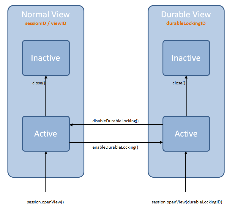

I spent quite a bit of time on this issue now. First I thought it should be solveable quickly, but after some more analysis I get the feeling that there's more to it. It's probably not just a matter of missing lock notifications but also of incorrect cached lock states. I've made a diagram to illustrate the state transitions of the two view types:
index.php/fa/40562/0/
Note that LockingManager.DurableView instances exist only inside the server locking manager and that they contain no information that arbitrary clients can/may use to identify them. In particular the durableLockingID is kind of a secret that only the owning client is aware of. So, when a view transitions from a normal (active) view to a durable (inactive) view, it's unclear how the CDOLockOwners inside distributed CDOLockStates can be represented.
I think the above view transitions need to be reworked in the light of lock notifications and cached lock states. New view state notifications need to be introduced and a way to identify DurableViews (used as CDOLockOwners) needs to be found...
