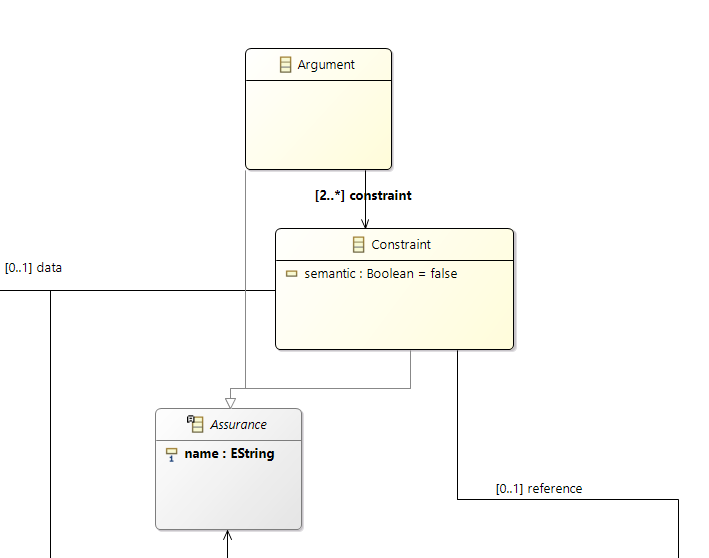

I have a class in my metamodel that has a relation based edge to multiple different types of classes. I am trying to specify one creation tool for it by using an if statement that with check the type of the target element in order to decide what type of feature to use to set the target value of the relation based edge. There doesn't seem to be a command that is available in AQL that will return the Ecore type as opposed to the OCL type and I was wondering if it is something that I will have to make custom or if I am missing some sort of obvious command here? Attached is a picture of my metamodel. The Constraint class is the one that has to different relation based edges in Data and Reference that I am trying to set.

Hi, I am not sure I understood 100% what you want to do, but how about:
If you want to check that the type is exactly "yourClass"
aql:target.oclIsTypeOf(yourNamespace::yourClass)
If you want to check that the target coerces to "yourClass" (i.e. it may be a subclass):
aql:target.oclIsKindOf(yourNamespace::yourClass)
