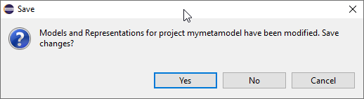

I saw that Sirius 6.4.2 is included in simrel 2021-03. I assumed this means it can be installed on Eclipse 2021-03 but I might be wrong.
The available update sites for Sirius 6.4.2 are 2020-03, 2020-06 and 2020-09 (list available on this page: https://download.eclipse.org/sirius/updates/releases/6.4.2 /).
I installed EcoreTools on Eclipse 2021-03. It works fine but there is a weird dialog that pops up when I click save all. I think this is the dialog that usually pops up when the last representation editor of a project is closed.
My question is: is this a bug or Sirius 6.4.2 is not officially compatible with Eclipse 2021-03? Do I have to fill out a bug report?
Thank you and good day.
Yann
Re: Dialog box on Save All on Eclipse 2021-03 [message #1841243 is a reply to message #1841016] Fri, 07 May 2021 10:27 Go to previous message
Hi Yann,
We have recently identified other similar problems with the "Save all" action, it seems that changes in the Eclipse platform are causing these issues (https://bugs.eclipse.org/bugs/show_bug.cgi?id=546766). We have modified our code on the Sirius side to fix the problem.
I was able to reproduce your problem on other versions of Eclipse and this even with our fix on the other "save all" issue. So to answer your question, Sirius 6.4.2 is well compatible with Eclipse 2021-03, but you can always fill a bug report, we may be able to adapt our code to solve this problem.
Thanks for your report and have a good weekend,
Glenn
