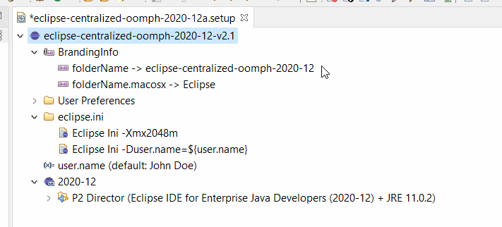

A use case that doesn't work (although I remember I have validated it years ago) is the scenario where we add new features/plugins in the "master" .setup file. So let's say that I installed the eclipse w/ this file:
index.php/fa/40429/0/

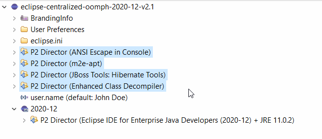

If I modify the .setup file by adding these 4 "P2 Director" tasks (cf. image below):
index.php/fa/40430/0/
Then when I restart Eclipse, it doesn't download the new plugins.
Am I mistaking when I say that this scenario should have worked?

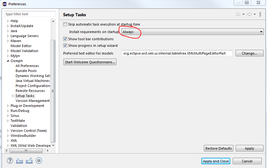

The problem may be that the following preference is not set to ALWAYS:
index.php/fa/40431/0/
Re: Adding new plugins to the "master" .setup file => no propagation on installed insta [message #1841021 is a reply to message #1841014] Fri, 30 April 2021 11:10 Go to previous messageGo to next message
Thanks Eike.
I tried with this setting set to "Always". Same result. The changes related to the plugins are not taken into account. Before was "Prompt". But I guess that even w/ "Prompt" it should have worked. I recall having seen this dialog in the past.
Cristian.

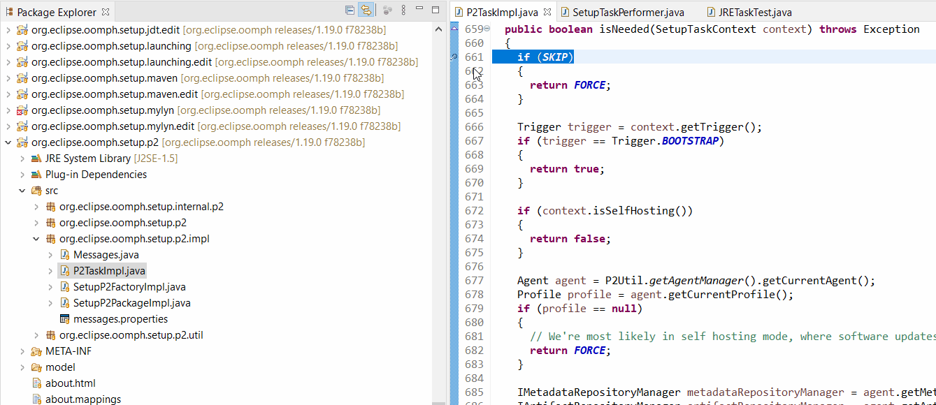

Normally the requirements are processed to consider if they are satisfied by what's current installed:
https://git.eclipse.org/c/oomph/org.eclipse.oomph.git/tree/plugins/org.eclipse.oomph.setup.p2/src/org/eclipse/oomph/setup/p2/impl/P2TaskImpl.java#n659
If there is no prompt, then everything that must be installed is already installed, though perhaps an older version of it (or the user has asked not to be informed). You can "force" updates more strictly by specifying stricter version ranges on the requirements .
Re: Adding new plugins to the "master" .setup file => no propagation on installed insta [message #1841027 is a reply to message #1841023] Fri, 30 April 2021 15:21 Go to previous messageGo to next message

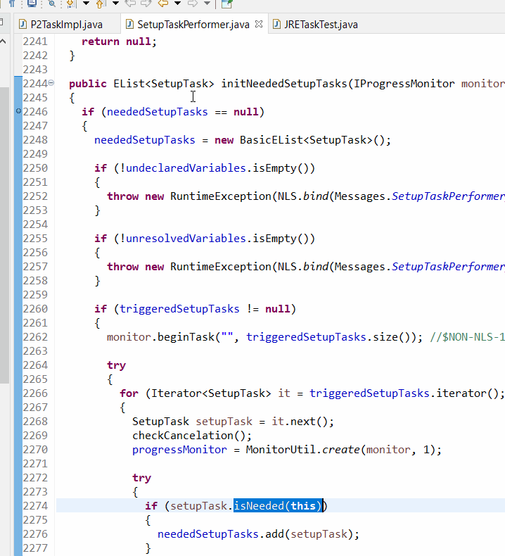

Ed: thanks for the pointer in the code.
The program doesn't enter this breakpoint.
index.php/fa/40434/0/

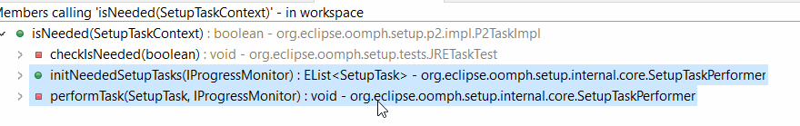

Looking at the "call hierarchy" shows me:
index.php/fa/40435/0/

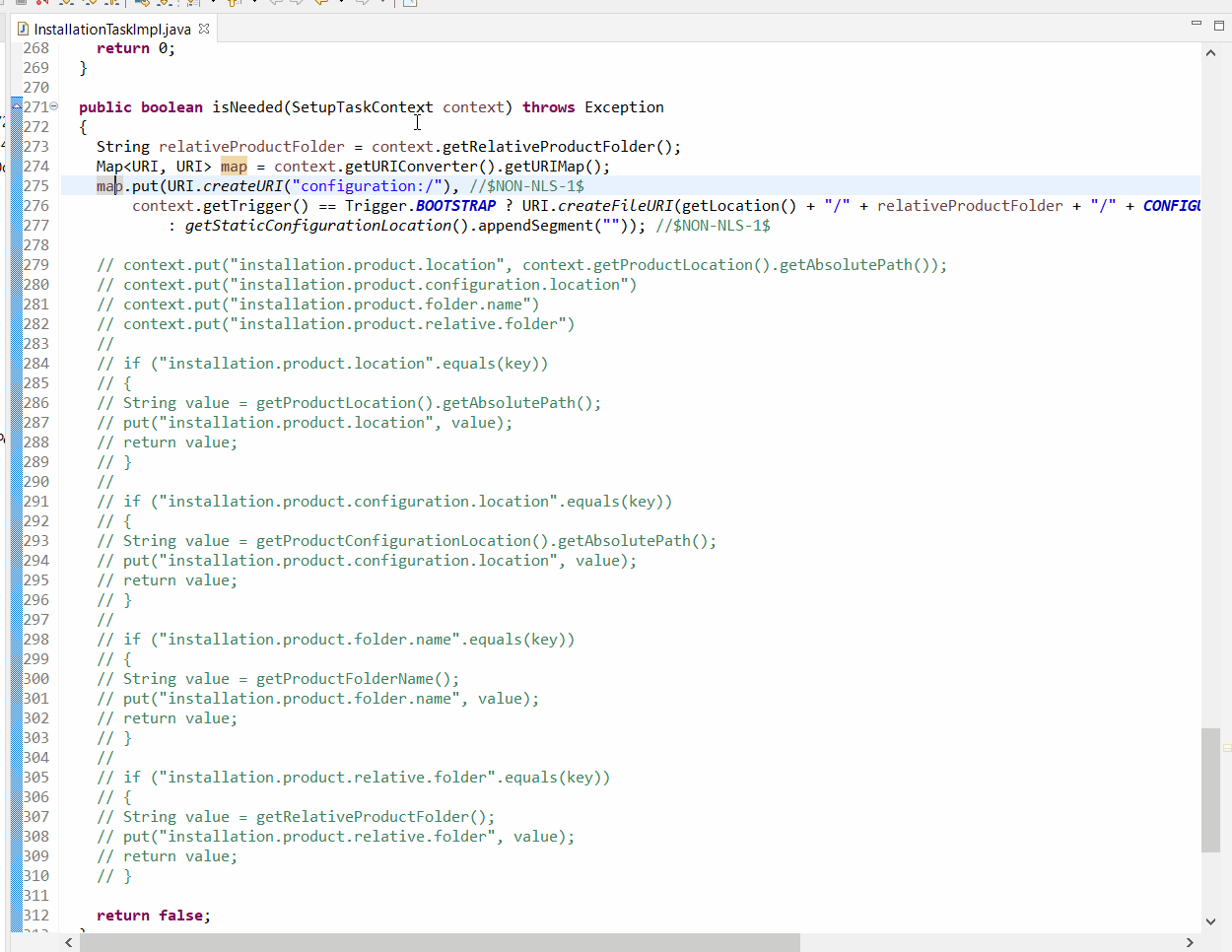

I pressed "send" too early. I wanted to show this as well:
index.php/fa/40437/0/
As the "InstallationTask" seems to be "commented out":
index.php/fa/40438/0/
=> In my opinion the issue starts more "at the root".

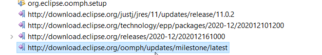

I confirm this both on a recent install (Eclipse 2012-12 + oomph 1.20) and for the other installs, that are a couple of months older (Eclipse 2020-12 + oomph 1.19). This difference comes from the fact that the update site for OOMPH is not "carved in stone" (like the other ones):
index.php/fa/40440/0/
Cristian.

Your comment about the breakpoint not being hit implies there is no p2 task in your list. Showing the Installation Task, which never actually needs to run, doesn't say anything about what's happening with your p2 task(s). Each task is tested.
If you manually do Perform Setup Tasks, you should see your p2 tasks. They should be up-to-date; perhaps they're not and that's why you see the behavior you see. If you see them they will definitely have been tested for isNeeded...

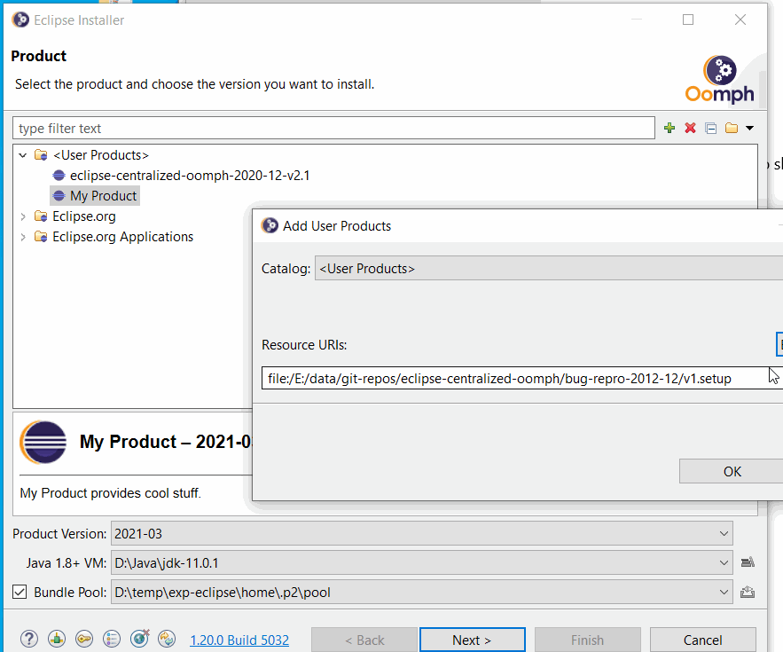

First I start the installer:
eclipse-inst-jre-win64.exe -vmargs -Duser.home=d:\temp\exp-eclipse\home -Doomph.setup.user.home.redirect=true
And I add the v1.setup file:

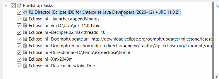

index.php/fa/40442/0/
We can observe the "p2" task containing only "Eclipse IDE..." + JRE ...".
index.php/fa/40443/0/

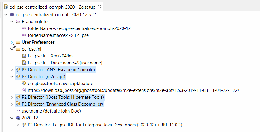

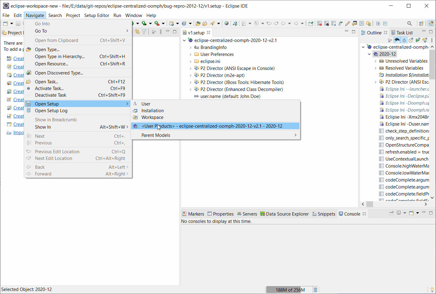

And then I modify the .setup file. I.e. like the v2.setup file. It contains 4 new plugins/p2 tasks:
index.php/fa/40444/0/
I start again the newly installed eclipse. And it DOESN'T execute the 4 new P2 tasks. From within the target eclipse I open the source .setup file, and the entries are "seen".
index.php/fa/40445/0/
Is it a bug w/ 2020-12? Or is there something that I'm doing wrong? And again: after modifying the .setup file to use the latest eclipse, 2021-03 => the mechanism functions correctly,
Cristian

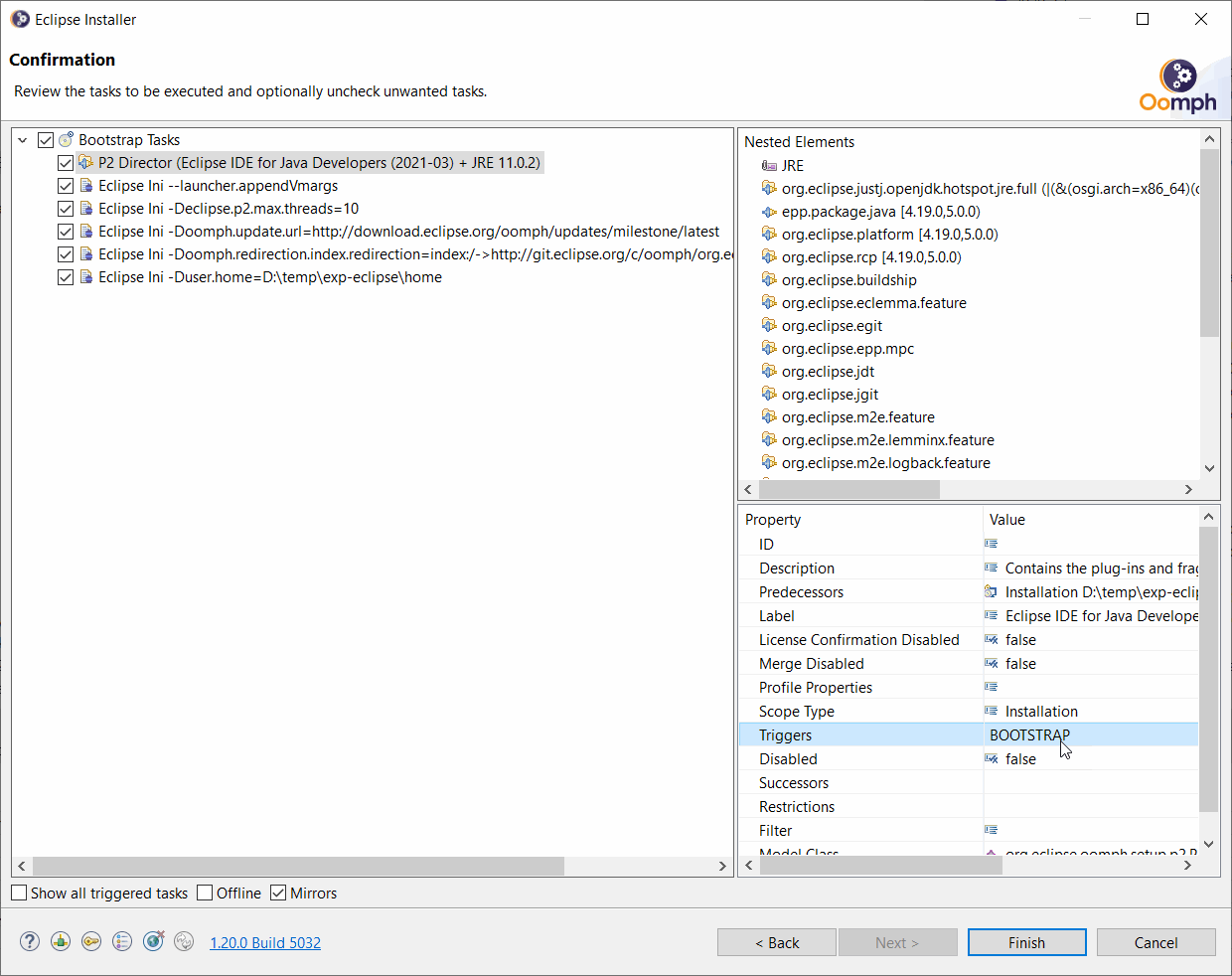

I tried yours and the problem is subtle. As you no doubt noticed, all the p2 tasks are merged into one. But the p2 task for the product version is set to trigger only for BOOTSTRAP; you need to unfilter the advanced properties to see that.. When the other p2 tasks are merged with this task, the final merged task is also only triggered for bootstrap. Hence there is no p2 task trigger on startup nor manual. Perhaps the merging behavior should consider the triggers differently... Is there a reason for specifying startup only?
Re: Adding new plugins to the "master" .setup file => no propagation on installed insta [message #1841042 is a reply to message #1841040] Sat, 01 May 2021 11:18 Go to previous messageGo to next message
Thanks Ed.
It's clear now. And I found a new notion. The property "Triggers". I wasn't aware of it.
It wasn't me who set it to "BOOTSTRAP". It came when I copied the "Product" from the Installer (in order to make my own .setup file).
I understand that the correct setting is: "BOOTSTRAP STARTUP MANUAL". Right?
And I understand that "Bootstrap" doesn't mean when Eclipse boots. But it means the initial setup process, which happens only once. Correct?
Thanks a lot for your help.
Cristian.

Hmm, certainly the setting you have is not the default and not is that way in the generated catalog.
Yes, typically you want a p2 task to perform at BOOTSTRAP (in the installer when first creating the installation), at IDE STARTUP , and when you MANUAL Perform Setup Tasks.
