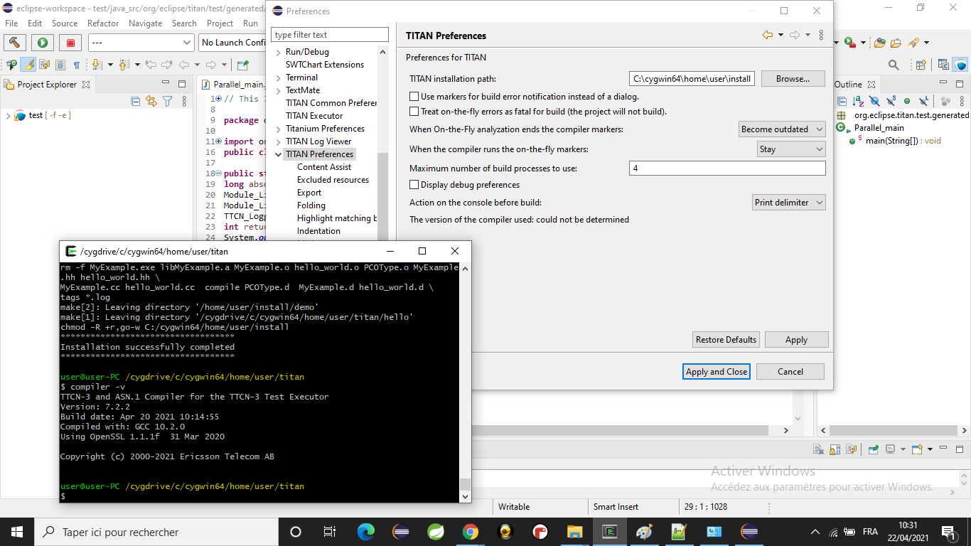

When I tries to set up the compiler version in Eclipse.
I faced the problem illustrated in the attached figure. which demonstartes also that the command compiler -v is working well and the version of the TTCN-3 compiler is equal to 7.2.2

Re: Compiler Version could not be determined [message #1840710 is a reply to message #1840708] Thu, 22 April 2021 06:10 Go to previous messageGo to next message
Please to try to close the Eclipse Preferences window and open it again. Sometimes it do not update the content of the page properly. Especially if you set the path for compiler install path for the first time.

Re: Compiler Version could not be determined [message #1840713 is a reply to message #1840711] Thu, 22 April 2021 06:52 Go to previous messageGo to next message
Which version of the Eclipse plugins you are using?
Do you installed the plugins that are available on the download site? here: https://projects.eclipse.org/projects/tools.titan/downloads
If so, please use it as it is at the time being. Regardless of that notification, the plugins should work properly with the compiler.
Re: Compiler Version could not be determined [message #1840714 is a reply to message #1840713] Thu, 22 April 2021 07:11 Go to previous messageGo to next message
I have installed the version 7.1.0
Re: Compiler Version could not be determined [message #1840724 is a reply to message #1840714] Thu, 22 April 2021 09:22 Go to previous message
Thank your for the feedback. The new Eclipse plugins package is on the way. That recognizes the newer compiler versions properly. Anyway, this just affects the recognition of versioning, therefore you should be able to use the currently installed plugins with the newest compiler.
