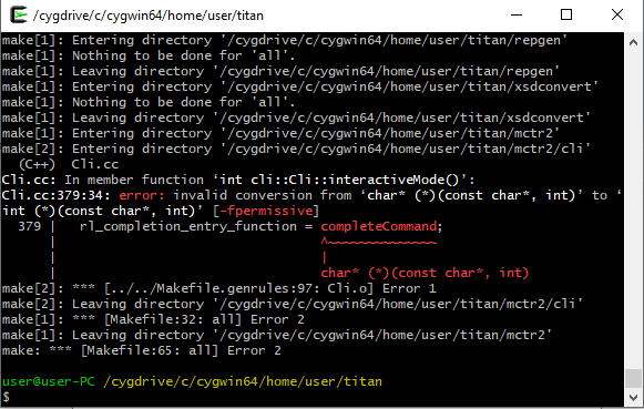

I have faced an error when trying to install Titan on windows 10
I have followed steps described in this tutorial :
https://www.eclipse.org/forums/index.php/t/1103718/
When I tape make -j I obtained the attached exception
Note that I have installed all required cygwin packages
  • Attachment: exception.png
    (Size: 27.45KB, Downloaded 108 times)
Re: Error when installing TITAN on windows10 [message #1840601 is a reply to message #1840596] Tue, 20 April 2021 09:01 Go to previous messageGo to next message
Set the
OLD_LIBEDIT := yes
in the Makfile.cfg
Re: Error when installing TITAN on windows10 [message #1840702 is a reply to message #1840601] Thu, 22 April 2021 04:47 Go to previous messageGo to next message
Thanks a lot.
It was installed now successfully.
