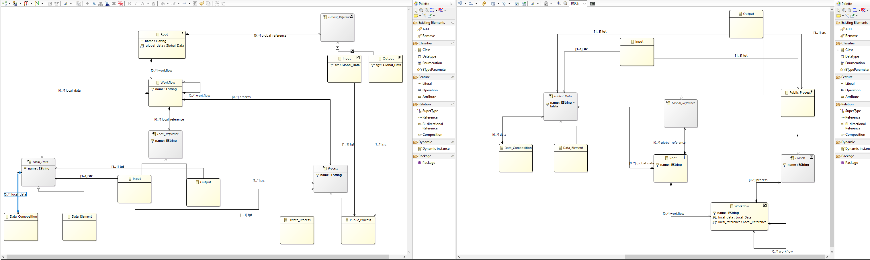

I have 2 metamodels that are dependent upon one another, show in the picture below:
index.php/fa/40349/0/
I am trying to define the Input and Output classes that inherit from Global_Reference in my Sirius editor however for whatever reason when I define them the graphics for those classes do not appear in my editor. Is there a reason for this? As far as I can tell I have the fields filled out properly. Is this a bug?
My goal is to be able to have the source of an Input class be a Global_Data class while the target is a Public_Process class.

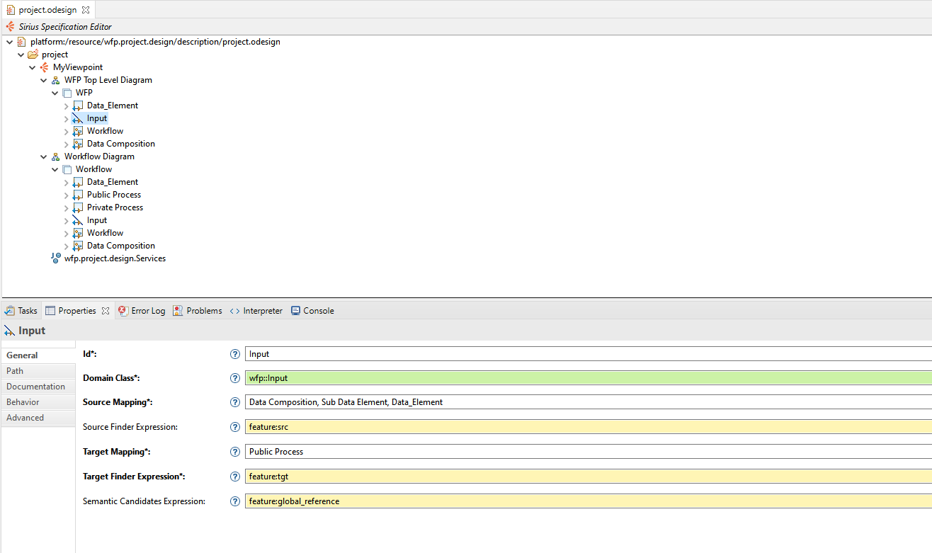

I have used the add elements tool in order to create the inter-dependent metamodels. The issue comes when I try to make an instance of them in Sirius. I have set all my concrete syntax definitions now to be synchronized but it still doesn't seem to create a graphical representation of my Input and Output classes in my editor. I suspected it was because the 'src' feature of the Input class is from one metamodel while the 'tgt' feature is from another, but then creating graphical representations for all of the non-reference classes works just fine so I was wondering if there was something else that I am missing now as well as the synchronized issue that you brought up.
index.php/fa/40377/0/
If it helps the image above is how I currently have the element based edge for the Input class defined.
[Updated on: Wed, 21 April 2021 12:32] by Moderator
Re: Element Based Edge in one editor across different metamodels [message #1840704 is a reply to message #1840662] Thu, 22 April 2021 04:56 Go to previous message
From the screeshot, your Input edge mapping uses source and target mappings like Public Progress and Data Element which are from another diagram definition. This is not supported, a diagram instance will only display instances of mappings from its own definition.
The Sirius Specification Editor unfortunately allows to chose all elements from anywhere in the file when choosing a source/target mapping, but ideally it should restrict the choices to the current diagram definition.
You can either create copies of the Public Progress mapping (and others) inside the WFP diagram (but it's more work to maintain), or define in WFP mapping imports which point to the original definitions from the other diagram definition.
