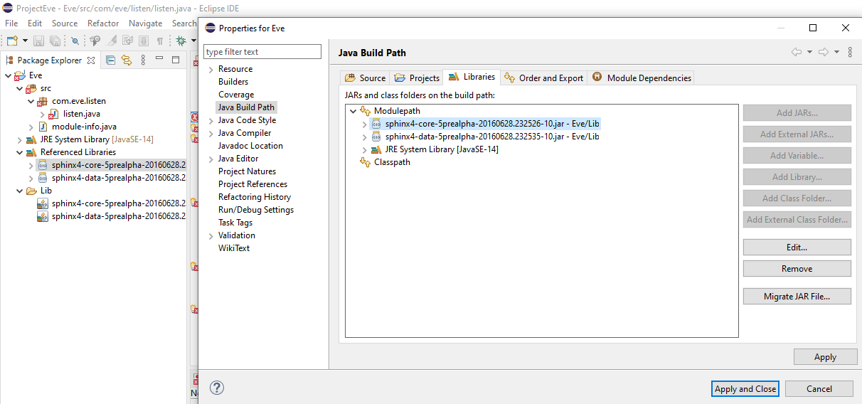

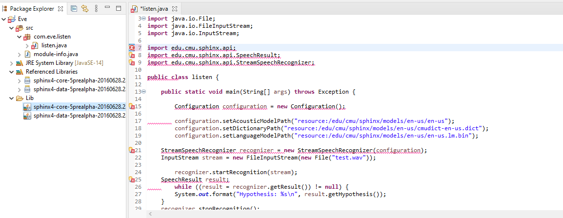

The problem is, that even though I have inserted the sphinx jar files into my build path, I am still getting the "Package __ is not accessible" red marks. (SS 1)
I followed this (I can't link it because I am *very* new. I'll link it in a reply message) manual on how to insert sphinx into my project, and I didn't use the maven or gradle stuff so I elected to download the jars from the repository, (link in the manual), and insert them into the project.
I then created a folder called lib in my project and inserted my jars there. And next I inserted the jars inside of the lib folder into buildpath. (SS2)
Finally I copied the first example given on the manual and I am left with the error.
I know the code requires a wav file, but that is not the issue currently, as it shouldn't give me accessible errors if it was the lack of a wav file that was the issue.

  • Attachment: 1.PNG
    (Size: 52.30KB, Downloaded 125 times)
  • Attachment: 2.png
    (Size: 60.98KB, Downloaded 112 times)
