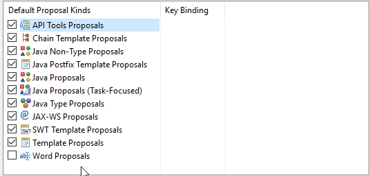

I am using the oomph installer with a custom setup file to install an Eclipse 2020 12R.
Now my problem is that the checkboxes in my preferences
Java -> Editor -> Content Assist -> Advanced -> Java Non-Type Proposals
Java -> Editor -> Content Assist -> Advanced -> Java Type Proposals
are not set after the installation.
How could I enhance my setup file that these checkboxes will be set with the install?

Well I want to have it like you see in my screenshot.
I had seen your post with disable_computers.
But I think that I would need enable_computers
Re: setup content assist [message #1839945 is a reply to message #1839940] Thu, 01 April 2021 13:15 Go to previous message
I'd have to investigate in detail how this is all represented in the preference tree. But recording the changes when I change it to what you show is like this:
<setup:PreferenceTask
    xmi:version="2.0"
    xmlns:setup="http://www.eclipse.org/oomph/setup/1.0"
    key="/instance/org.eclipse.jdt.ui/content_assist_disabled_computers"
    value="org.eclipse.jdt.ui.textProposalCategory${0x0}"/>
Did you actually try this?
Note that another functionality is the "Capture Preference" dialog. There you can create preference task based on the current settings of the preferences. If I filter all the preference to content_assist_ then I don't see anything like what you want. So my sense is that everything not explicitly disabled is therefore enabled.
