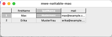

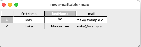

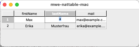

This works fine on Linux. Unfortunately, when the KeyEditAction is triggered on macOS, the text field content is replaced with the first pressed key, then the text field is activated which causes SWT to select all text (the single character) and as soon as the use rpresses more keys the first (selected) character is deleted.
I attached a minimal working example which should demonstrate this behavior.
