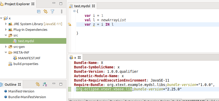

hi, i cannot reproduce. sure you added mydsl.libs to the cp of the model/example project?

Hi Christian,
My bad, I was missing the mydsl.lib project in CP :(
