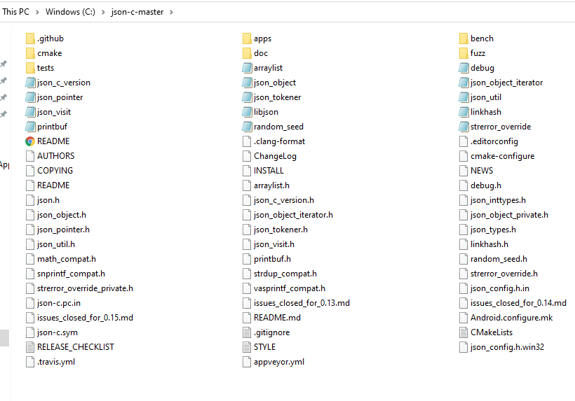

Re: How to use Json-c parser or any other parser in Eclipse for C programming in Windows [message #1839749 is a reply to message #1839741] Sat, 27 March 2021 03:44 Go to previous messageGo to next message
Thanks for your response.
What did you mean by "include files". Does it ,mean header and c files.
I use MinGW.
I have these files in the json-c folder.
index.php/fa/40230/0/
  • Attachment: jsonc.png
    (Size: 41.92KB, Downloaded 747 times)
[Updated on: Sat, 27 March 2021 03:46] by Moderator
Re: How to use Json-c parser or any other parser in Eclipse for C programming in Windows [message #1839759 is a reply to message #1839749] Sat, 27 March 2021 10:26 Go to previous message
Yes, usually headers and not very often c source.
You appear to be facing a very large learning curve.
This forum is not for programming questions.
I suggest you search the web for a tutorial on using this library
or ask at its github site.
