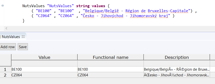

I'm trying to display and edit an UTF-8 text in a NatTable and I'm not sure what I'm missing.
I have managed to display it correctly by implementing a DisplayConverter.
class UTF8DisplayConverter extends DisplayConverter {
		public Object canonicalToDisplayValue(Object canonicalValue) {
			byte[] bytes = canonicalValue.toString().getBytes();
			return new String(bytes, StandardCharsets.UTF_8);
		public Object displayToCanonicalValue(Object displayValue) {
			return displayValue.toString();
The problem is that as soon I'm editing it the characters are 'going back' to the 'weird' ones (the ones that I had before implementing the Converter).
Is there anything that I have to implement in addition to the Converter or is the Converter not correct implemented?
Thank you!

Indeed, that example works for me too.
Maybe the file that I'm using as 'support' for the NatTable is not behaving correctly.
At least now I know that from the NatTable point of view everything is correct and I can investigate in other directions.
