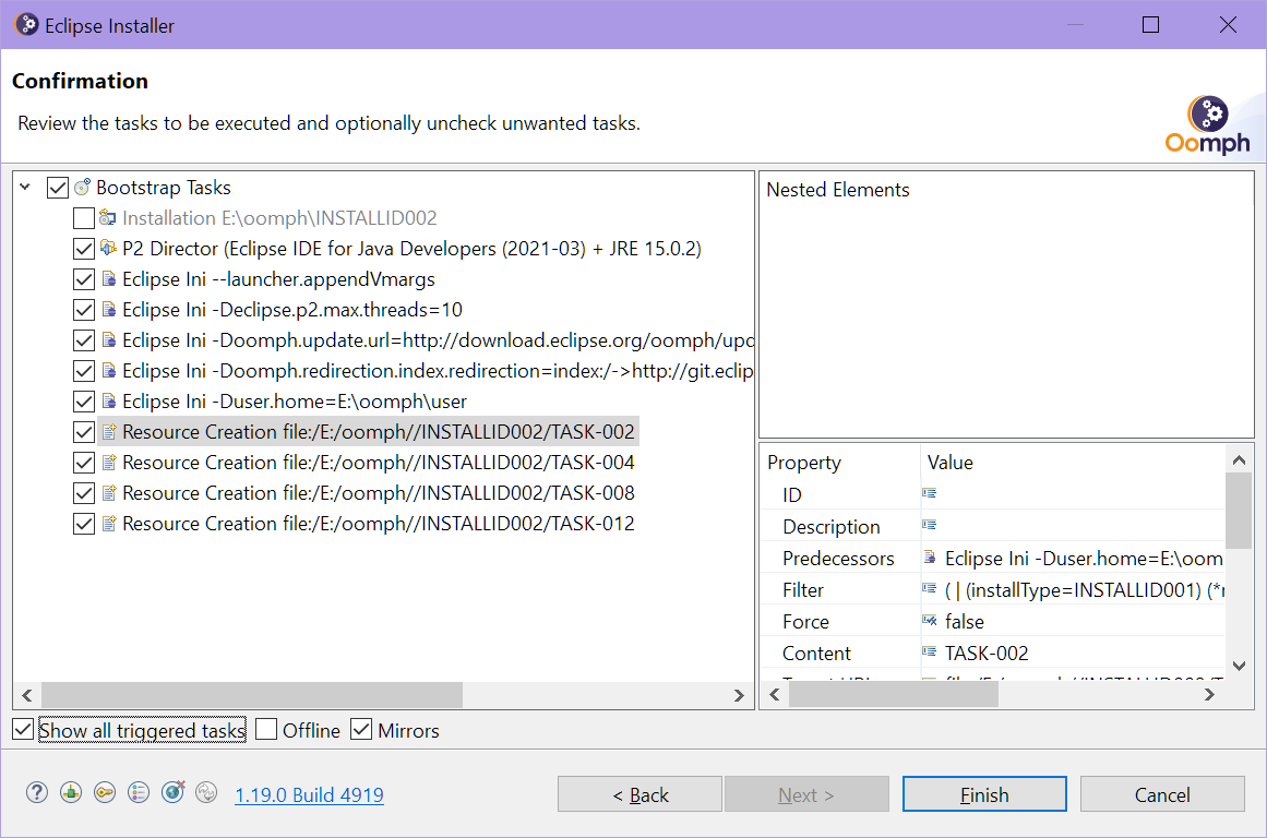

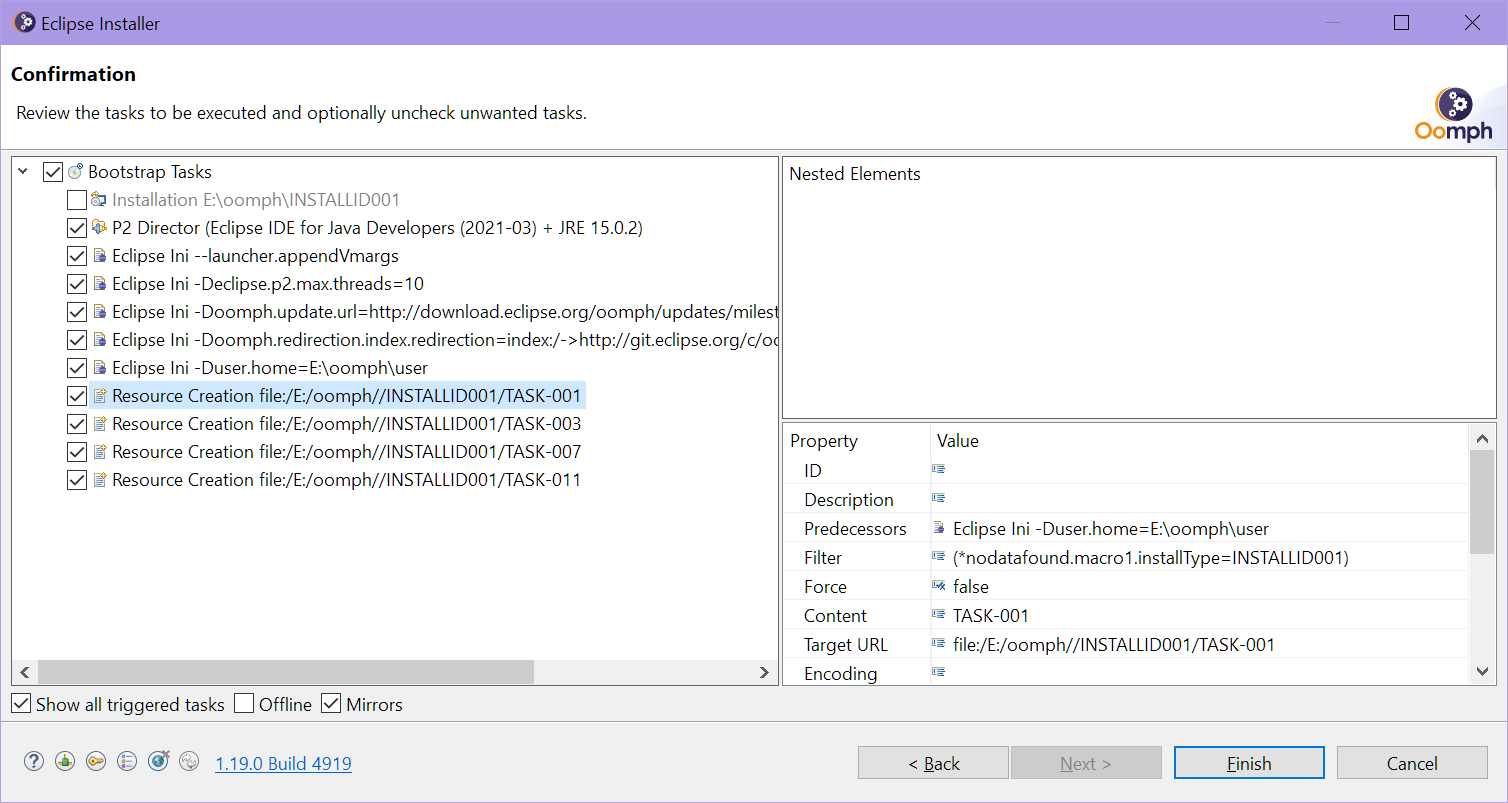

And the installer shows me that:
index.php/fa/40179/0/
index.php/fa/40180/0/
You can see in the second screenshot (INSTALLID002), the filter of TASK-002 is transformed from ( | (installType=INSTALLID001) (installType=INSTALLID002)) to ( | (installType=INSTALLID001) (*nodatafound.macro1.installType=INSTALLID002)).
I would expect the following tasks for INSTALLID001 : TASK-001 to TASK-012,
And for the second INSTALLID002 : TASK-002, TASK-004, TASK-006, TASK-008, TASK-010 and TASK-12
I am perhaps doing my filter wrong, I'm not accustomed to infix notation :)
Beside, I fail to understand the use case of "*" in the variable name/reference or in the filter.
Is that only for parameters ? If yes, shouldn't the installer/editor report an error instead ?

There's definitely a bug that all the varialbes in the filter are not replaced properly (for more complex filter expressions).
I tried changing org.eclipse.oomph.setup.internal.core.SetupTaskPerformer.FILTER_MEMBER_PATTERN to this:
private static final Pattern FILTER_MEMBER_PATTERN = Pattern.compile("(\\(\\s*)([^|&!~<>=\\(\\)]+)([~<>=\\\\(\\\\)][^\\)]+\\))"); //$NON-NLS-1$
That appears to do a better job. Please open a Bugzilla.
