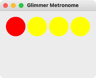

While going through drum pad practice yesterday, I noticed that my iPhone metronome app was broken after the latest update as it was ticking up on the second beat, not the first anymore. It was a small thing, but quite annoying, so I deleted the app and wrote my own Metronome app in Glimmer DSL for SWT in under 10 minutes for the initial working 4/4 rhythm version (please don't mind the initial rough code).

Anyways, I later revised it, adding a beat count option in addition to the BPM (beats per minute), with auto-grow/shrink support for the window shell when adding/subtracting beats.
Learn more at this blog post:
https://andymaleh.blogspot.com/2021/03/glimmer-metronome-hello-canvas.htmlhttps://andymaleh.blogspot.com/2021/03/glimmer-metronome-hello-canvas.html
