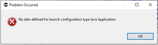

Hi --
When I install Eclipse and then launch from the installer, I get a perfectly functional Eclipse.
If I terminate Eclipse and then restart using the desktop shortcut created by the installer (or executing eclipse.exe directly), for example, I find that Run | Run Configurations produces an exception creating launch configuration tabs (see attached pictures).
To get Eclipse to work properly, I have to delete it and re-install it, and launch Eclipse from the installer again.
What could be going wrong here?? Are there runtime options missing in the desktop shortcut?
(Other features break, too, but I thought I'd keep this question simple.)

Re: Starting up badly in Windows 10 [message #1838718 is a reply to message #1838712] Thu, 04 March 2021 01:10 Go to previous messageGo to next message
Does your eclipse.ini have a -vm option in it? Is that the one that you choose to use on the second page of the installer?
There is a bug in the 2020-12 installer that the application launched from the installer is using the installer's JRE:
https://bugs.eclipse.org/bugs/show_bug.cgi?id=569513
But that should cause the opposite problem that you're seeing. I.e., the IDE launched by the installer should not work quite right. Hence the question about the -vm argument in the eclipse.ini because that's the JRE/JDK that will be used and that apparently isn't working quite right.

Hi, all --
Based on the kind responses by Ed Merks and David Karr, I dug a little deeper, and I think I have the culprit.
During the installation process, there was a prompt to choose the JVM ... it looks like the requirement was that I choose something that was JVM 11 or later. The default was a JRE 11 I had installed for a different application. So, I chose it. (See screenshot)
index.php/fa/40084/0/
When I wipe out my Eclipse and use the installer, but choose JRE 15.0.2, all functions work as expected.
So, I think the problem may have been my using JRE 11 instead of JRE 15.
I'm not sure whether there's a difference between the JRE 11.0.2 offered by the installer and JRE 11.0.6 I was selecting.
I think I'm quite happy, though, that Eclipse is working! (BTW, I'm on Eclipse 2020-12.)
Any comments?

Re: Starting up badly in Windows 10 [message #1838784 is a reply to message #1838780] Thu, 04 March 2021 17:55 Go to previous messageGo to next message
If that Java 11 distribution is actually a JRE, and not a JDK, then it would fail in various ways. I imagine your Java 15 JRE Is actually a JDK, as that worked. Eclipse needs a JDK.
Re: Starting up badly in Windows 10 [message #1838786 is a reply to message #1838784] Thu, 04 March 2021 18:55 Go to previous message
I think that's exactly right ... the JRE was needed/installed for Cytoscape, which doesn't require a JDK.
This might explain a lot of what I saw ... like failure of Eclipse's debug-oriented packages to load.
