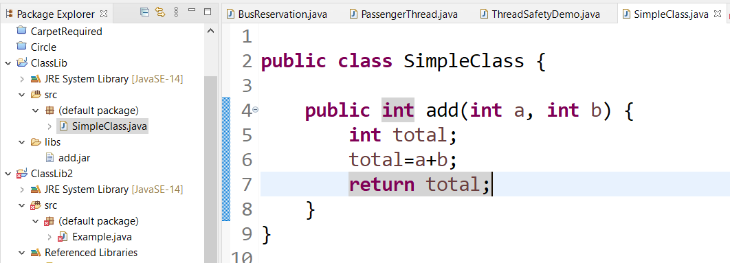

I created a very simple Java project with a single class that has a single method to add 2 numbers together.
I export the project as a Jar file.
I add the Jar file to a new project using Build Path-> Add External Archives
I can see the class and method in the Jar file.
I exported both class files and Java files.

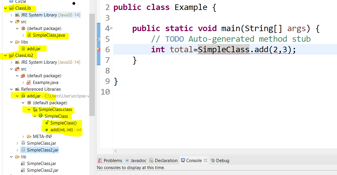

However an error occurs when I reference them in the code.
I have attached a screenshot. ClassLib is the original project I exported the Jar from. ClassLIb2 is where I am trying to use it.
Any ideas why this is happening.

No - it's not defined as static. I have included a screenshot.

It seems your problem has nothing to do with eclipse.
You need to call your method as Instance method.
Example:
package examples;
public class MySimpleClass {
	public static int add_UsingStaticMethod(final int a, final int b) {
		return a + b;
	public int add_UsingInstanceMethod(final int a, final int b) {
		return a + b;
package examples;
public class Main {
	public static void main(final String[] args) {
		new Main();
	 * Using MySimpleClass
	public Main() {
		System.out.format("add_UsingStaticMethod %d \n", MySimpleClass.add_UsingStaticMethod(10, 20));
		// Note the use of "new"
		System.out.format("add_UsingInstanceMethod %d \n", new MySimpleClass().add_UsingInstanceMethod(11, 21));
Advice: get The Java Tutorials Bundle and start from the beginning

Thank you for your reply. So in all scenarios where I am exporting Jar files, do I need to call my method as an instance method?
Re: Project Cannot see exported Jar [message #1838742 is a reply to message #1838735] Thu, 04 March 2021 06:57 Go to previous messageGo to next message
You can have both Static and Instance methods in the same exported jar.
It depends on the requirement and design of the application.
