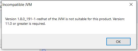

Hello.
Is there a way to restrict the Eclipse installer to update to a specific version?
Currently we have JAVA 8 and when I upgraded Eclipse installer now it ask me for a JAVA 11. I attached a picture of the error.
I think with version 1.18.x we didn't have this issue.
We cannot deploy java 11 yet and I was wondering how can I restrict the update only to a version that supports java 8.
Re: Restrict Eclipse installer to update only to a version that support JAVA 8 [message #1838659 is a reply to message #1838656] Wed, 03 March 2021 03:14 Go to previous message
I'm not entirely sure this is related to the installer itself. The latest installers are restributed containing a JRE and will not produce such a message.
I know the IDE was changed to check during the update process if the current JRE is sufficient to be the JRE needed by the update, but you may well have an even older version of the IDE installed that doesn't do such a check.
In the installer itself, you can switch to advanced mode via the menu in the upper right. There you can choose older versions of the product and can see which version of Java that the older version requires. The installer also allows you to choose a JRE to be installed specifically and only for the use by IDE; in that IDE you can still use Java 8 as your JDK/JRE for development purposes via the JRE preferences.
