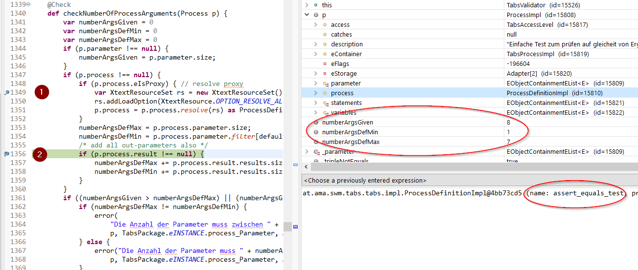

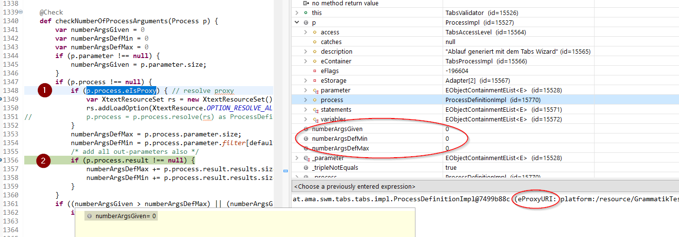

Referenced DSL-Files are not recognized on clean [message #1838543] Mon, 01 March 2021 04:45 Go to next message
We have a DSL where the parameters of calls are defined in separate Files. Those are normally read and parsed automatically. We also have a validator to check those parameters.
Now when we edit the dsl file containing the call, everything is normal. But if I do a clean, all parameters become red underlined. Debugging reveals that at this stage the definitions of the separate files have not been read yet, hence no validation is possible.
Also the stack trace of an edit validation is completely differend from a clean validation, when setting the halt point inside the validation.
How comes? And what is the solution to this problem?
Though the error goes away after insertion of a blank this behaviour is very confusing for the users. Even in some cases (this cannot always be reproduced) it is necessary to reopen the file, to get rid of thoses false errors.

It is standard EMF practice when unloading Resources to proxify all references. If a clean is provoking an unload, then a failure to re-resolve references may be at the root of your problem.

After long debugging I found out, that Xtext/Eclipse did not resolve proxy-objects correctly. After resolving them by hand, everything worked.
Here is the altered code:
@Check
def checkNumberOfProcessArguments(Process p) {
var numberArgsGiven = 0
var numberArgsDefMin = 0
var numberArgsDefMax = 0
if (p.parameter !== null) {
numberArgsGiven = p.parameter.size;
if (p.process !== null) {
if (p.process.eIsProxy) { // resolve proxy
var XtextResourceSet rs = new XtextResourceSet();
rs.addLoadOption(XtextResource.OPTION_RESOLVE_ALL, java.lang.Boolean.TRUE);
p.process = p.process.resolve(rs) as ProcessDefinition
numberArgsDefMax = p.process.parameter.size;
numberArgsDefMin = p.process.parameter.filter[defaultValue === null].size;
/* add all out-parameters also */
if (p.process.result !== null) {
numberArgsDefMax += p.process.result.results.size;
numberArgsDefMin += p.process.result.results.size;
if ((numberArgsGiven > numberArgsDefMax) || (numberArgsGiven < numberArgsDefMin)) {
if (numberArgsDefMax != numberArgsDefMin) {
error(
"Die Anzahl der Parameter muss zwischen " + numberArgsDefMin + " und " + numberArgsDefMax + " sein",
p, TabsPackage.eINSTANCE.process_Parameter, NUMBER_ARGS)
} else {
error("Die Anzahl der Parameter muss " + numberArgsDefMin + " sein",
Re: Referenced DSL-Files are not recognized on clean [message #1838692 is a reply to message #1838691] Wed, 03 March 2021 12:13 Go to previous messageGo to next message

But apparently it does not resolve. See uploads, fist without resolving, second with.
PS: It happens not always but in some cases.
