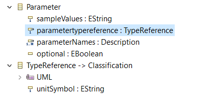

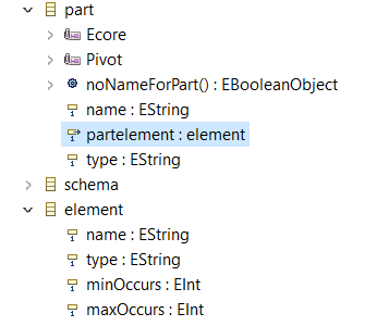

I am trying to achieve aM2M transformation using ATL. So I am transforming Source (first figure ) class named "part" and its properties to Target (second figure) class named "Parameter" and its properties.
index.php/fa/40052/0/
index.php/fa/40053/0/
I would like to transform part(partelement) property to Parameter(parametertypereference) so i wrote the following ATL transformation:

However, when i run the transformation it donesn't seem to transform the Ereference "partelement" from "part" to "element" into "parametertypereference", which is from "Parameter" to "TypeReference" and i get the following error:

Very difficult to comment with such a scanty repro.
I see an unusual mix of PIvot / UML / SettingDelegate and use of the same spelling for a type and a property. The former suggests poor initialization for which you provide no clues at all. The latter might be a tooling bug.
The error messages although verbose seem quite forceful. Your types are wrong. I'm not an ATL expert but perhaps you have a missing type conversion rule.
