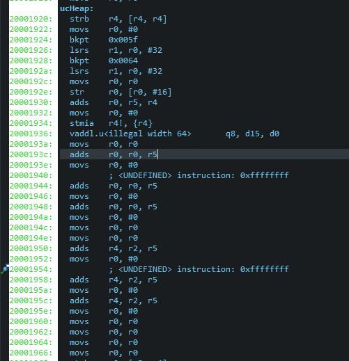

I debugged the Disassembly, Hard Fault doesn't trigger on a specific instruction but always somewhere in the creation of Queue or Semaphore when it jumps to the heap in RAM. There are 2 undefined Instructions in my heap but I'm not sure where they are coming from
0x20001940:    ;<UNDEFINED> instruction: 0xffffffff
same a couple of bytes later. (see attached screenshot)

Update: I used syscalls and sysmem from an example for my board from the official STM32Cube_FW package, but apparently there was an issue (symbols for heap end where different for example). I replaced both with ones created by cubeMX now the Hard Fault is gone :/
