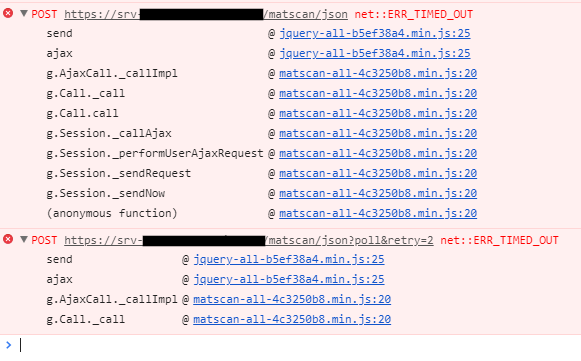

Dear Claudio,
thanks for your answer.
I think you are right that the problem is that the js in the browser can't send the value to the ui server. I was able to connect one of the mobile devices with usb, enable debug mode on the enterprise browser and connect with the chrome dev tools on my notebook. To simulate the sleep mode/connection loss I disconnected the mobile device from the access point . It takes some seconds for the scanner to reconnect to the wifi network. During that time I entered the data into the field and voila the Please wait screen appears. Most of the time it doesn't disappear even when whe device is connected again. Instead it takes some time and then two errors appear in the debug console of my local chrome:
index.php/fa/40011/0/

Are you sure that the request is not being processed by the UI server when the please wait popup appears? Normally, if there is a connection loss, Scout goes into offline mode and starts a Reconnector that regularly pings the UI server trying to reconnect. During that time the reconnect notification is shown.
index.php/fa/40017/0/
In your case, the browser either does not notice the connection loss or the request is stuck in the UI server. Can you reproduce this behavior with a regular smart phone? If I disable the wifi or put my smartphone on flight mode it correctly goes into offline mode and reconnects as soon as I enable regular mode again.
Scout does not use a timeout for regular requests because they could possibly last very long (e.g. if the processing really takes some time). If you want you can change it by adjusting the default ajax options. To do so you need to extend the Session.js class and override the method defaultAjaxOptions. Please see the technical guide to learn how to replace the default Session class using the object factory: https://eclipsescout.github.io/8.0/technical-guide-js.html#object-factory
This behavior has not been changed for Scout 10 and 11.
