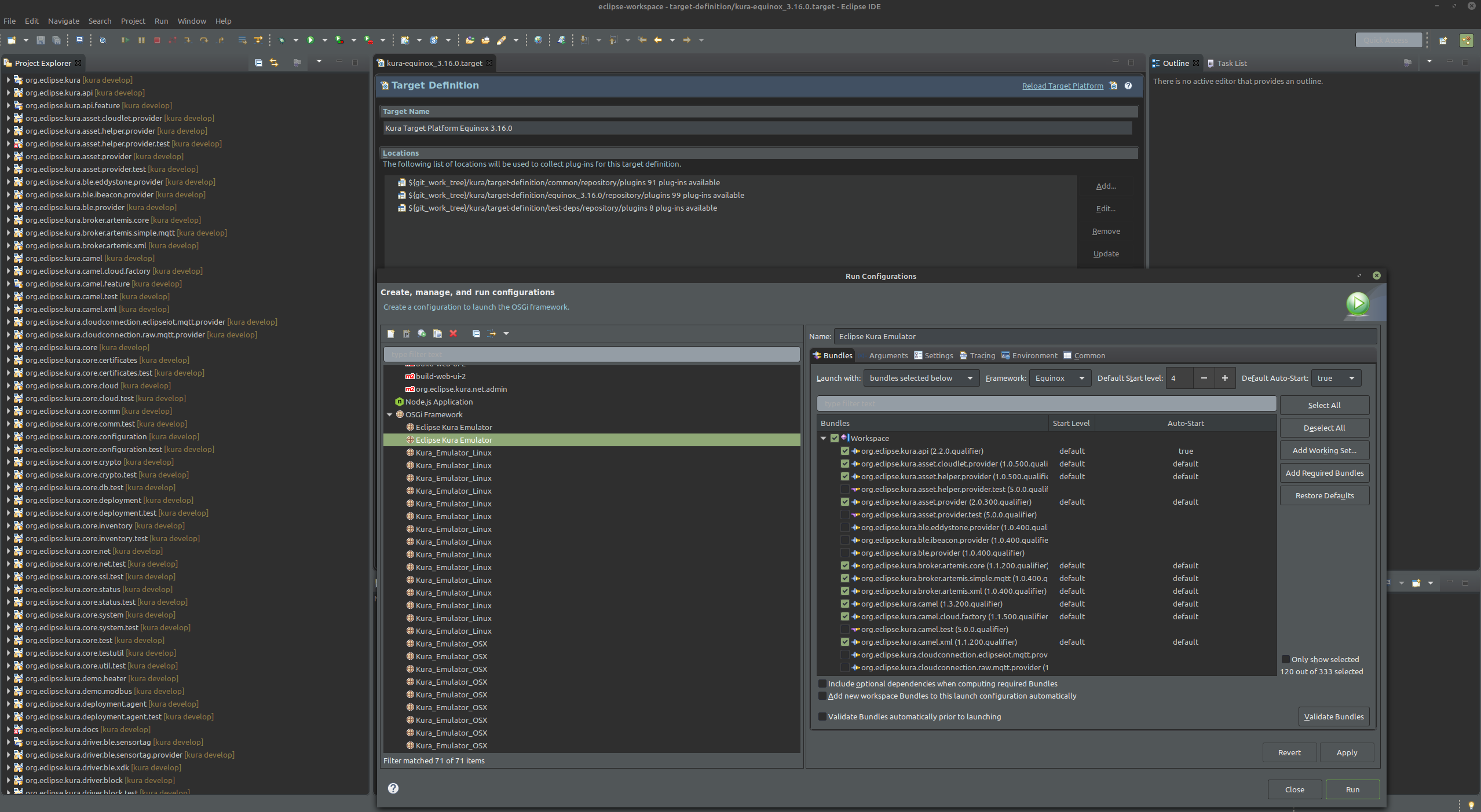

Hi Metteo, thanks for your reply. I am currently trying to import the Kura Git repository (developer) into Eclipse as described in the Git. For this I took the Eclipse EE 2019.06 and selected OOmph in the import section and imported Kura there. But I can't start the emulator because some bundles are not found and some bundles have errors.
My workspace looks like this:
see attachement
The error message when I start the emulator looks like this:

!MESSAGE FrameworkEvent ERROR
!STACK 0
org.osgi.framework.BundleException: Could not resolve module: org.eclipse.kura.core.cloud [12]
  Unresolved requirement: Import-Package: org.eclipse.kura.core.util; version="[1.0.0,2.0.0)"
    -> Export-Package: org.eclipse.kura.core.util; bundle-symbolic-name="org.eclipse.kura.core"; bundle-version="1.0.600.qualifier"; version="1.2.0"
       org.eclipse.kura.core [19]
         Unresolved requirement: Import-Package: org.h2; version="1.4.199"
  Unresolved requirement: Import-Package: org.eclipse.kura.core.data
    -> Export-Package: org.eclipse.kura.core.data; bundle-symbolic-name="org.eclipse.kura.core"; bundle-version="1.0.600.qualifier"; version="1.1.0"
	at org.eclipse.osgi.container.Module.start(Module.java:463)
	at org.eclipse.osgi.container.ModuleContainer$ContainerStartLevel$2.run(ModuleContainer.java:1845)
	at org.eclipse.osgi.internal.framework.EquinoxContainerAdaptor$1$1.execute(EquinoxContainerAdaptor.java:136)
	at org.eclipse.osgi.container.ModuleContainer$ContainerStartLevel.incStartLevel(ModuleContainer.java:1838)
	at org.eclipse.osgi.container.ModuleContainer$ContainerStartLevel.incStartLevel(ModuleContainer.java:1781)
	at org.eclipse.osgi.container.ModuleContainer$ContainerStartLevel.doContainerStartLevel(ModuleContainer.java:1743)
	at org.eclipse.osgi.container.ModuleContainer$ContainerStartLevel.dispatchEvent(ModuleContainer.java:1665)
	at org.eclipse.osgi.container.ModuleContainer$ContainerStartLevel.dispatchEvent(ModuleContainer.java:1)
	at org.eclipse.osgi.framework.eventmgr.EventManager.dispatchEvent(EventManager.java:234)
	at org.eclipse.osgi.framework.eventmgr.EventManager$EventThread.run(EventManager.java:345)
!ENTRY org.eclipse.kura.core.configuration 4 0 2021-03-19 09:53:24.794
!STACK 0
org.osgi.framework.BundleException: Could not resolve module: org.eclipse.kura.core.configuration [14]
!ENTRY org.eclipse.kura.core.deployment 4 0 2021-03-19 09:53:24.796
!STACK 0
org.osgi.framework.BundleException: Could not resolve module: org.eclipse.kura.core.deployment [16]
  Unresolved requirement: Import-Package: org.eclipse.kura.core.inventory.resources; version="[1.0.0,2.0.0)"
!ENTRY org.eclipse.kura.core.net 4 0 2021-03-19 09:53:24.798
!STACK 0
org.osgi.framework.BundleException: Could not resolve module: org.eclipse.kura.core.net [17]
!ENTRY org.eclipse.kura.core 4 0 2021-03-19 09:53:24.800
!STACK 0
org.osgi.framework.BundleException: Could not resolve module: org.eclipse.kura.core [19]
!ENTRY org.eclipse.kura.emulator.net 4 0 2021-03-19 09:53:24.848
!STACK 0
org.osgi.framework.BundleException: Could not resolve module: org.eclipse.kura.emulator.net [24]
  Unresolved requirement: Import-Package: org.eclipse.kura.core.net; version="[1.0.0,1.1.0)"
    -> Export-Package: org.eclipse.kura.core.net; bundle-symbolic-name="org.eclipse.kura.core.net"; bundle-version="1.0.600.qualifier"; version="1.0.5"
!ENTRY org.eclipse.kura.web2 4 0 2021-03-19 09:53:24.858
!STACK 0
org.osgi.framework.BundleException: Could not resolve module: org.eclipse.kura.web2 [33]
  Unresolved requirement: Import-Package: org.apache.felix.useradmin; version="1.0.0"
!ENTRY org.eclipse.kura.wire.component.provider 4 0 2021-03-19 09:53:24.867
!STACK 0
org.osgi.framework.BundleException: Could not resolve module: org.eclipse.kura.wire.component.provider [37]
  Unresolved requirement: Import-Package: org.eclipse.kura.core.configuration.metatype; version="[1.0.0,2.0.0)"
    -> Export-Package: org.eclipse.kura.core.configuration.metatype; bundle-symbolic-name="org.eclipse.kura.core.configuration"; bundle-version="2.0.300.qualifier"; version="1.0.0"
  Unresolved requirement: Import-Package: org.eclipse.kura.asset.provider; version="[2.0.0,2.1.0)"
    -> Export-Package: org.eclipse.kura.asset.provider; bundle-symbolic-name="org.eclipse.kura.asset.provider"; bundle-version="2.0.300.qualifier"; version="2.0.0"
       org.eclipse.kura.asset.provider [4]
         Unresolved requirement: Import-Package: org.eclipse.kura.core.configuration.util; version="[2.0.0,3.0.0)"
           -> Export-Package: org.eclipse.kura.core.configuration.util; bundle-symbolic-name="org.eclipse.kura.core.configuration"; bundle-version="2.0.300.qualifier"; version="2.0.0"
         Unresolved requirement: Import-Package: org.eclipse.kura.core.configuration; version="[2.0.0,3.0.0)"
           -> Export-Package: org.eclipse.kura.core.configuration; bundle-symbolic-name="org.eclipse.kura.core.configuration"; bundle-version="2.0.300.qualifier"; version="2.0.0"
!ENTRY org.eclipse.kura.wire.provider 4 0 2021-03-19 09:53:24.874
!STACK 0
org.osgi.framework.BundleException: Could not resolve module: org.eclipse.kura.wire.provider [40]
Framework is running in emulation mode

Re: Kura and Java 11 [message #1839669 is a reply to message #1839317] Thu, 25 March 2021 08:32 Go to previous messageGo to next message
it may be that currently develop is broken in terms of the default configuration of the emulator.
For now I may suggest to manually select the missing dependency and retry to start the environment
Re: Kura and Java 11 [message #1840641 is a reply to message #1838069] Wed, 21 April 2021 04:57 Go to previous message
The same error, all are already selected.
