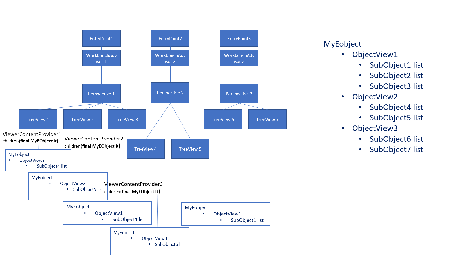

I setuped a project with RAP, and I created several entry points to display different perspectives and views.
I'm loading the same object from an xmi in a configurator defined in an EmfParsleyGuiceModule.
What I would like to to is to filter this big EObject depending the TreeFormView.
My problem is that ViewerContentProvider that I defined is defined in my EmfParsleyGuiceModule which is project wide so, I cannot make my filtering on views like I want.
Is there a solution to have a different content provider for each TreeFormView I defined ?
I'm attaching a schema of the architecture I would like to reach.
