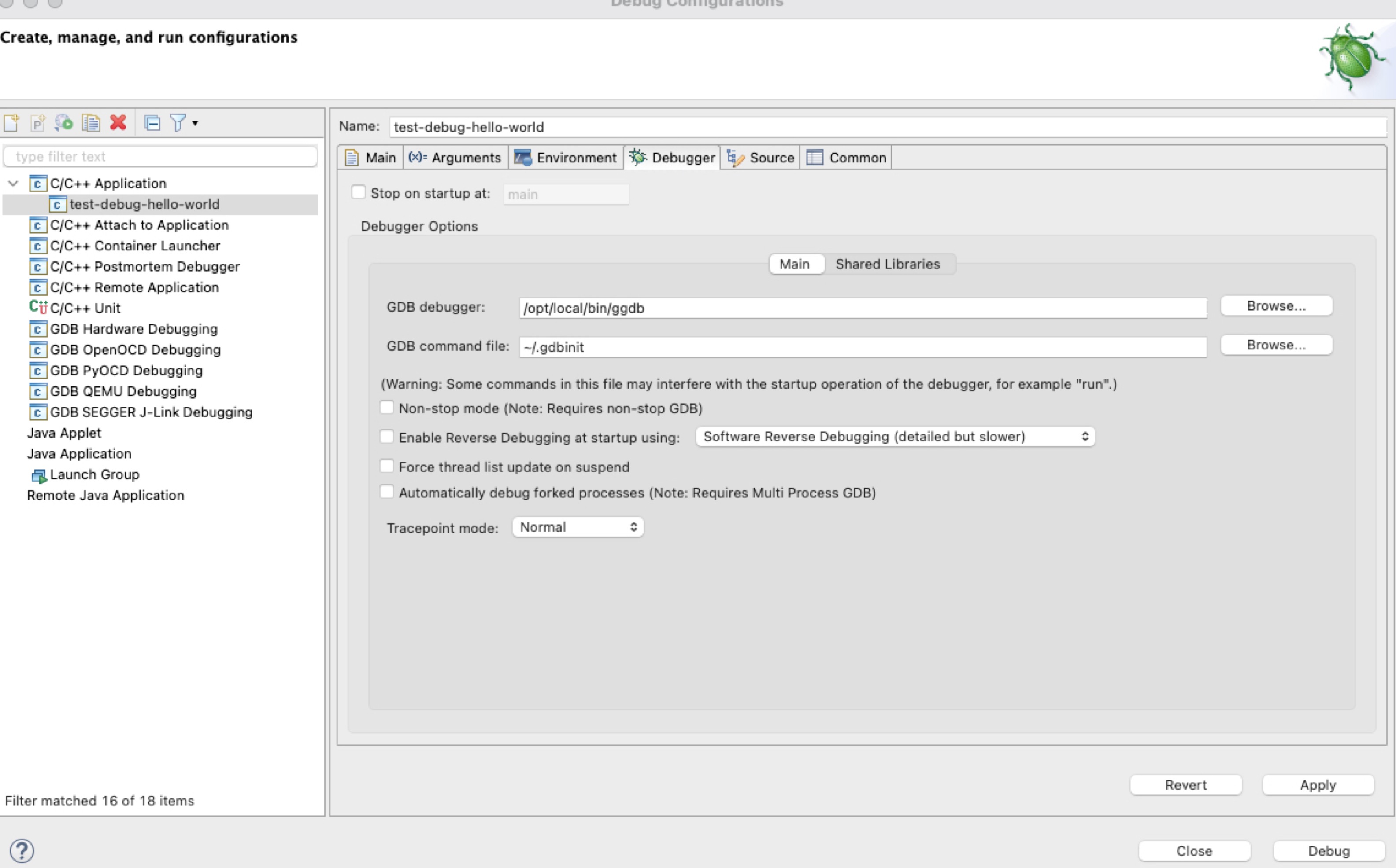

Hello
A new user to ECLIPSE on MAC OSX is here.
I cannot figure out what is wrong in using gdb with Eclipse.
The gdb debugger does not appear to be stopping at any breakpoint. It appears as if the execution has stalled.
All debug buttons ("Step Over", "Step Into") are deactivated/disabled.
I am showing the issue through a "Hello World" example: Created by
File->New->Project-> C/C++ project-> A CMake Project with a Hello World Executable to get started->test-hello-world-> finish
The project builds perfectly.
Debug Configuration is shown in the attached screenshot.
After that, using
Run->Debug History->test-debug-hello-world
leads to nothing.
My console shows the message
Building in: /Users/egad/eclipse-workspace/test-hello-world/build/cmake.debug.macosx.x86_64
cmake --build . --target all
[100%] Built target test-hello-world
Build complete (0 errors, 0 warnings): /Users/egad/eclipse-workspace/test-hello-world/build/cmake.debug.macosx.x86_64

Re: MAC OSX ECLIPSE C/C++ Debugger does not seem to stop at breakpoint [message #1838903 is a reply to message #1837923] Mon, 08 March 2021 18:58 Go to previous messageGo to next message
Also a new MacOS user having similar issues and looking for any advice.
Hello World program compiles and runs without issues, and I can see from console it is being compiled with debug symbols.
I can also run debug interactively the project-built binary using gdb (10.1) at the command line. This proves out (I hope) that I correctly brew installed, and subsequently code signed gdb, without issues.
I know that the debug configuration is pointed at the right gdb file as the 'Debug' option will error if I say change its name to gdb-not, and will not give an error when I revert.
I do not however know how to get further details in the console. When I add an 'echo' command to my ~/.pdbinit it seems to be being ignored.
Re: MAC OSX ECLIPSE C/C++ Debugger does not seem to stop at breakpoint [message #1838906 is a reply to message #1838903] Mon, 08 March 2021 21:05 Go to previous message
Downgrade to an earlier gdb version fixed the problem as described here: https://stackoverflow.com/questions/65867339/im-currently-experiencing-an-error-with-gdb-debugging-on-eclipse-macos-big-sur/66539786#66539786
