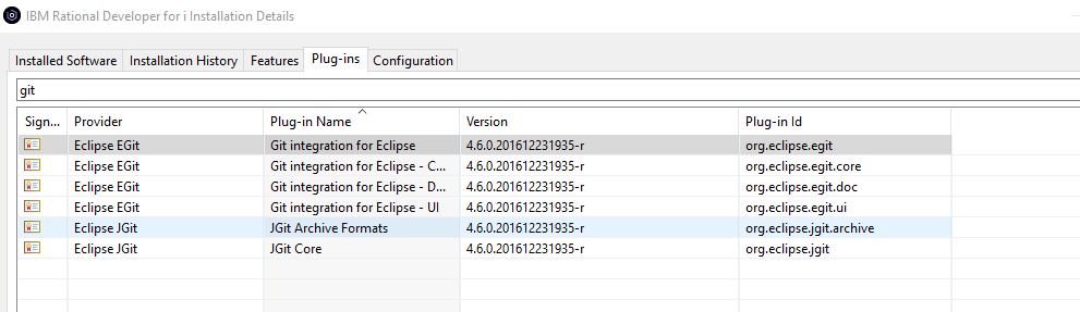

I am trying to clone a Git repository in RDi (Rational Developer for i), and I have the following message:
git-upload-pack: not found (See the doc file Error.docx)
I am using IBM Rational Developer for i Version: 9.6.0.8 20200403_1723
and EGit/JGit version : 4.6.0.201612231935-r
Could you please advise
Thanks.

This means no git server is running on the end you are trying to clone from.
If you access this repository via filesystem access then use the file protocol.
