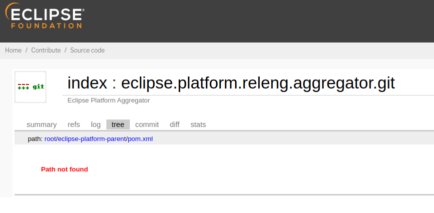

Re: How to compile and package the eclipse compiler? [message #1856426 is a reply to message #1837564] Fri, 09 December 2022 03:20 Go to previous messageGo to next message
Hello Ed Merks, I have the same problem as you answered in the question 13 years ago, I think it was right. But now this link is not working. Can you suggest another one or how to compile it all, if I have the same error at the moment? I really appreciate any help you can provide.
Re: How to compile and package the eclipse compiler? [message #1856428 is a reply to message #1856426] Fri, 09 December 2022 04:27 Go to previous messageGo to next message
That repo is moved to here:
https://github.com/eclipse-platform/eclipse.platform.releng.aggregator
