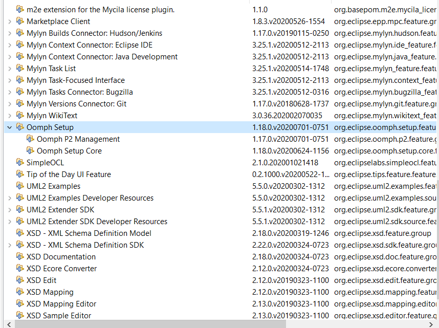

I would like to mention that I actually used the help>install new software to install the OCL package, however, it still didn't work.
I have checked the installation details to inspect any installations that are non 2020-06 contribution. I found the following installation, which is 2020-07 if I'm not wrong (check the figure below).
index.php/fa/39891/0/
However, I can't figure how to replace/update it to be compatible with my current Eclipse version, as I don't wish to update my Eclipse right now, if it is possible.

Re: Issue with mdt-ocl-Update sites [message #1837605 is a reply to message #1837589] Wed, 03 February 2021 01:02 Go to previous message
You only show the bottom half of your install list. Your OOMPH install is only one week after 2020-06 and while it uses EMF, I wouldn't have expected EMF to move on that rapidly; it is probably just a bug fix. However post 2012-06 we start the nightmare of moving on from Java 8 that prevented an 2020-09 release of OCL. It may be that OOMPH has started something that depends on something that is affected by the Java 11 migration.
