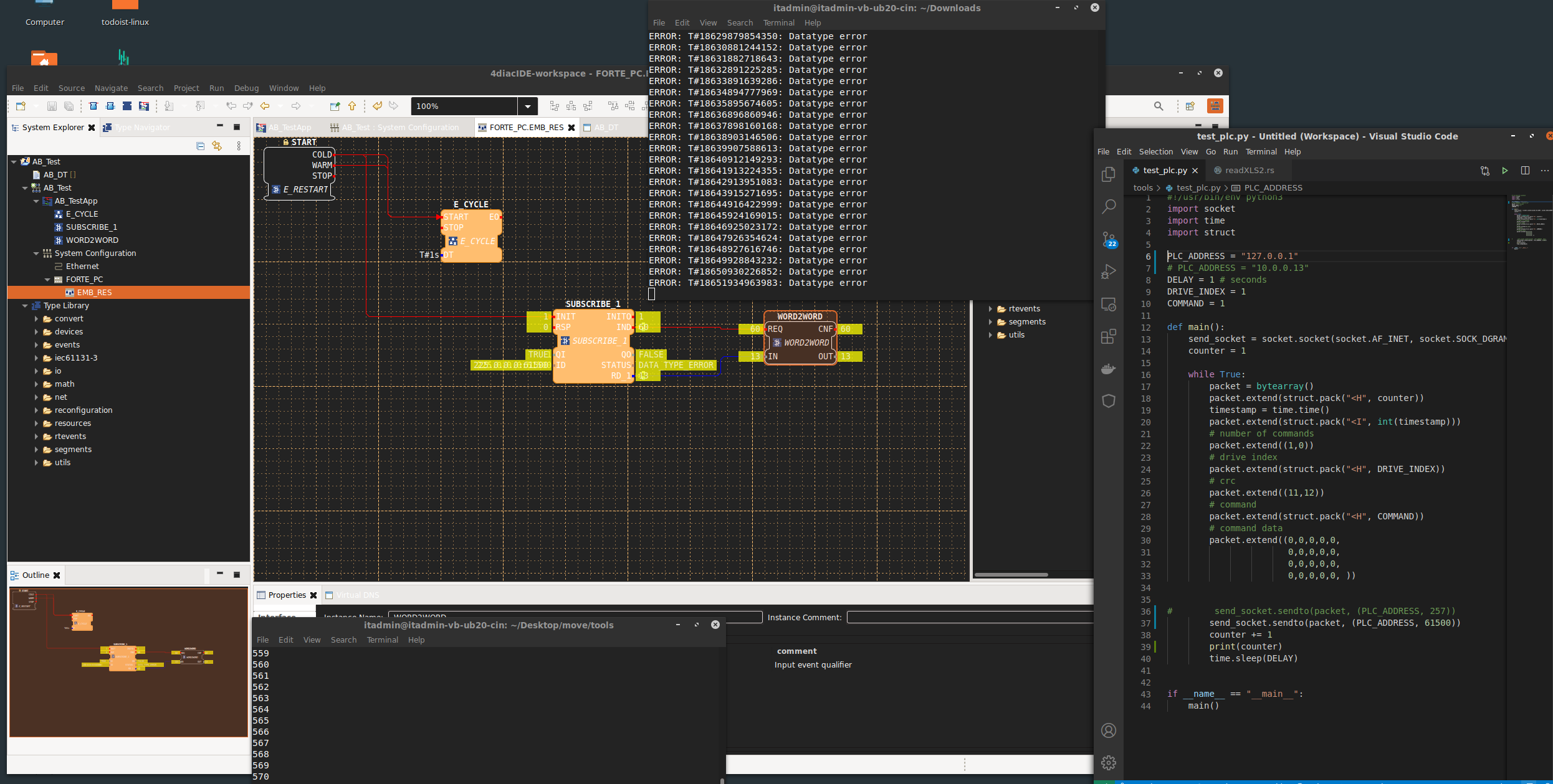

Trying to recive a UDP message and have a IP_ADD_MEMBERSHIP message
What does it mean ?
See Picture
written simply python program to send test data
Running 13.1 on linux with FORTE as sudo
Can anyone point me on in the right direction ?
Asterios
Re: IP_ADD_MEMBERSHIP [message #1837548 is a reply to message #1837543] Tue, 02 February 2021 02:27 Go to previous messageGo to next message
As already pointed out in another message the default SUBSCRIBE FB expects as configuration parameter a UDP Multicast address and a port. However you gave a UDP Uni-Cast address. In oder that 4diac FORTE can receive UDP multicast data in a real network it needs to send out this IGMP Membership message. However you are lucky and 4diac FORTE should still receive the data. The reason that you are not receiving any data is most probably your Ubuntu setup. You need to check if your loop back device is configured correctly and that you are routing UDP messages via loop back device. I noticed with some of my students using Ubuntu that there is a problem.
Furthermore I saw that you are using an E_CYCLE connected to the INIT of your SUBSCRIBE FB. This is not needed. IEC 61499 is fully event driven. That means you don't need to continuously trigger SIFBs. Especially resource initiated SIFBs like the SUBSCRIBE FB (you can identifie these with the IND output). These FBs will register themselves to the 4diac FORTE with the INIT event and will produce IND events as soon as they have some data ready for the application.

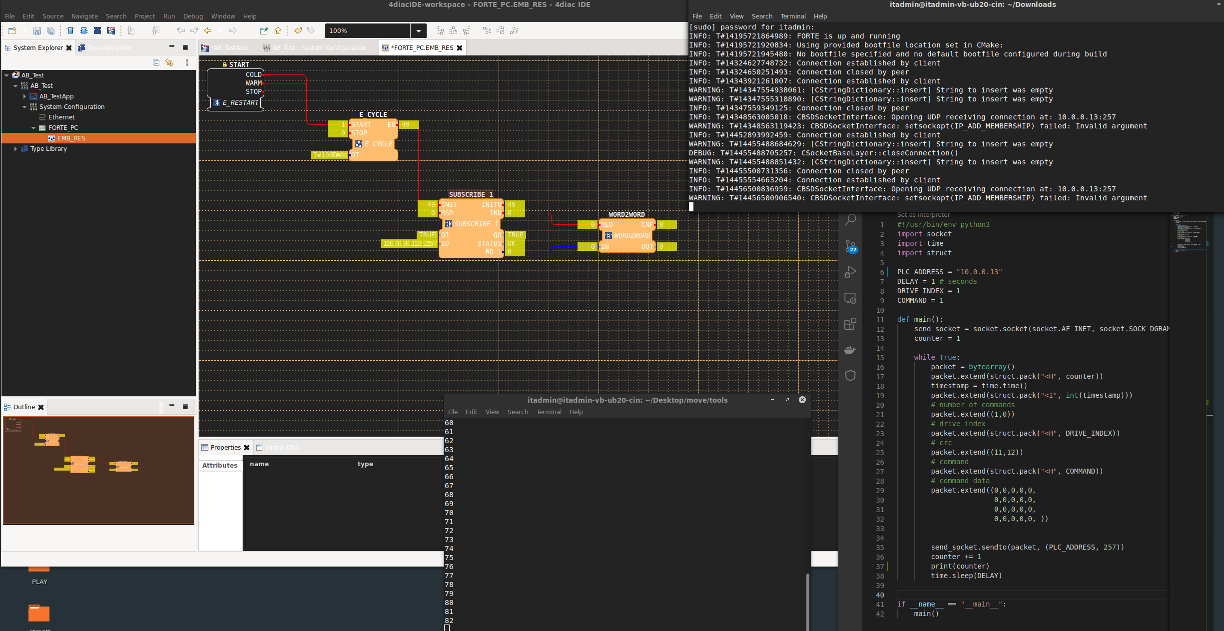

Re: IP_ADD_MEMBERSHIP [message #1837620 is a reply to message #1837549] Wed, 03 February 2021 05:13 Go to previous messageGo to next message
Hi Alois
Again, thank you for your support
I changed my port, and ID parameters, and finally have recived something
See Picture, I get a Datatype error, I assume that I have to move the data to a word array ?.
I did play around and created one.
My question is that is the only way to use this is make my own FB ?
If so then to use my own FB I must compile my new FB into FORTE ?
Re port 257, as I get better with 4diac, would like to use this port as the scada system prefers to send data on this port.
Asterios
Re: IP_ADD_MEMBERSHIP [message #1837659 is a reply to message #1837620] Wed, 03 February 2021 14:04 Go to previous messageGo to next message
In the default version of a SUBSCRIBE FB expects data packet in the format as given in the "IEC 61499 compliance profile for feasibilty demonstrations" [1]. If you need a different data format it may be a better idea to have your own communication layer on top of the UDP layer. There you can implement an according decoding method. You can find more information on how to do that in our development documentation [2].
I'm not sure what the problem with 257 port is. If it is not used by any other application on your computer it should in general work. But as said in my post above I would expect that it is a linux config issue.
