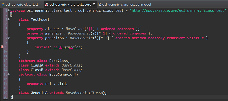

Here is a sample project https://github.com/AresEkb/ocl_generic_class_test
The model contains a generic class and a derived reference with OCL expression.
The OCLinEcore editor shows the following error:
"java.lang.IllegalArgumentException: Incorrect template bindings for template type"
index.php/fa/39871/0/
And also when I run a genmodel I get the error "Failed to pre-generate ocl_generic_class_test constraints" with exception:

Does Java code generator support generic classes?
Re: Generate Java code for generic classes [message #1837503 is a reply to message #1837493] Mon, 01 February 2021 04:38 Go to previous messageGo to next message
https://bugs.eclipse.org/bugs/show_bug.cgi?id=570802 raised.
