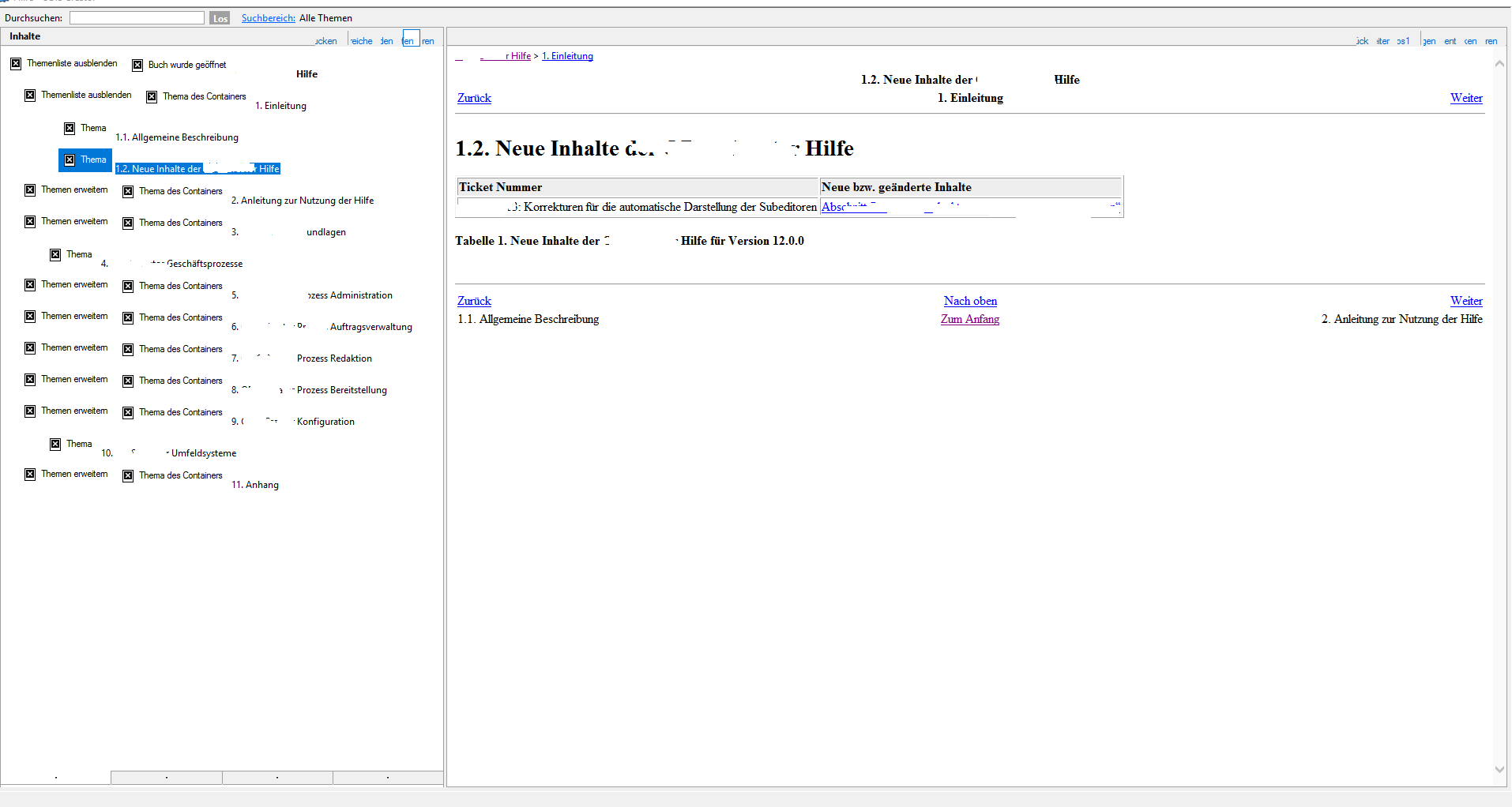

I'm facing strange behaviour in my RCP on a customers computer only: Icons for the TOC tree can't be loaded by the RCP Help System framework. The alt text gets displayed instead.
Unfourtunately on my PC it runs fine, so i'm pretty lost on how to debug/fix this. Both the customer and me using Windows 10 with Internet Explorer. I'm thinking about some rights issues and enterprise security rules which may affect my customers PCs, which led to unloadable icons, but on the other side: it's just a Jetty server and the icons are avaiblable in the proper bundles, so it has to work. Supposed to work ...

See attached file for the TOC tree without icons.

Re: RCP Help System: Tree icons could not be loaded [message #1837568 is a reply to message #1837420] Tue, 02 February 2021 09:17 Go to previous message
It seems to have something to do with the svg icons inside org.eclipse.help.webapp: After switching them to PNG, they can be loaded on customers computer.
